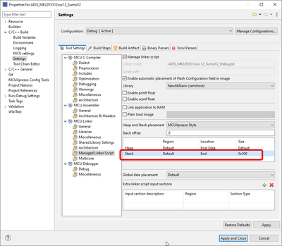

Hello Team,
This is regarding a Hardfault issue in LPC55S69.
I have created a c++ project and implemented changes for my project. As part of it, I am making use of C++ STL library features.

But I am getting a hardfault error, in the initialization routine while inserting the elements. I am wondering, what is going on here.
Can someone please let me know, what the issue is?

Hi @sushmasan ,
both heap and stack (MSP) size you can easily change in the linker settings in MCUXpresso IDE (no linker file modification needed). Here are the settings with the MPS stack marked:
As for PSP (process stack pointer): this is used for the stacks of threads. Settings is depending on the RTOS used, for example for FreeRTOS it is a configuration define:

sushmasan
While debugging the code, what I noticed was the heap size increasing which is very close to 100%, that's when hardfault is triggered. When I checked the allocated stack and heap size it was 4KB, that was the reason for the failure. After configuring the heap size to 8KB, the code worked just fine. The heap size used was around 6.2KB.
As you mentioned try more space for MSP, PSP stack. How can I do that?

ErichStyger
Specialist I
Hi @sushmasan ,

ErichStyger
Specialist I
to add to that: the stack size for each task in FreeRTOS is assigned as parameter in the xTaskCreate() API call.

ErichStyger
Specialist I
Looks like a possible stack overflow to me. Try to reserve more space for your MSP and PSP stack.
Other than that: this is the hardfault handler I'm using:
