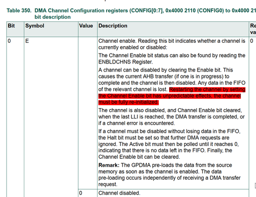

Based on Table 350. DMA Channel Configuration registers (CONFIG[0:7]
Bit 0
  • If set b'0 to 1, then the DMA will start transfer?
  • If DMA transfer completed, this b'0 will auto set from 1 to 0?

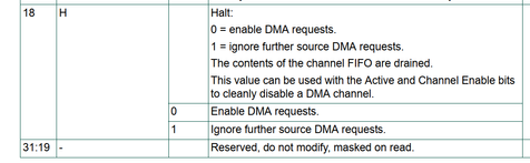

Bit 18
  • If I want to setup DMA request signal, should I set to b'18 to 0 and b'0 to 0 ? then I can expect  DMA channel will enable/activate to startup transfer when DMA_request signal arrival?

Bit 0
Q1)If set b'0 to 1, then the DMA will start transfer?
>>>>>Yes
Q2)If DMA transfer completed, this b'0 will auto set from 1 to 0?
>>>>I do not think the bit will update to 0 automatically after DMA transfer completed.
Bit 18
Q3)If I want to setup DMA request signal, should I set to b'18 to 0 and b'0 to 0 ? then I can expect  DMA channel will enable/activate to startup transfer when DMA_request signal arrival?
>>>>The bit 0 is DMA channel enable bit, the bit 18 is DMA channel request enable bit, if you want to DMA work, both bits must be enabled.

After my tested.
  • bit0 will automatically reset to 0, after transfer completed
  • no matter bit18 is 0 or 1, DMA always begin transfer.  but I will like to DMA waitting DMA_req siganl to stat transfer. is any idea?

DMA is working at b'0 is immediate. but I want to DMA trigger by DMA_req with bust mode.
