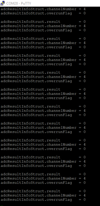

when I connect the J12_2 to GND, the sample is all 0 as the following Fig with the code:

So no problem for the ADC converter even if using PLL.

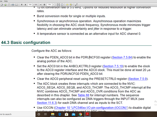

I am facing problem while operating the core at 100 MHZ derived from PLL. The ADC output drops considerably.
The 20 usec delay to be provided after PDRUNCFG0 PDEN_ADC0 bit is not there in the drivers provided by MCUXpresso SDK.
So please eveluate the performance at 100 MHz PLL clock stepped down to 1 Mhz and fed to ADC module.

I have used ADC channel 4(J12_2 on LPCXpresso54808 board, PIO0_16/ADC0_IN4) to test the external voltage, when I connect the J12_2 to 3.3V, the sample is from 4091~4093 as the following Fig.
when I connect the J12_2 to GND, the sample is all 0 as the following Fig.
In conclusion, the ADC has not issue.
Xiangjun Rong
