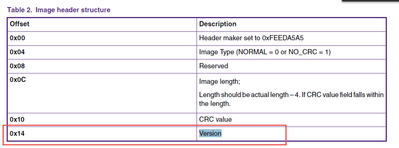

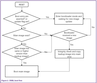

Hello @EmilL
The bootloader boot image refer to Version in image header:
You can refer to boot flow:
