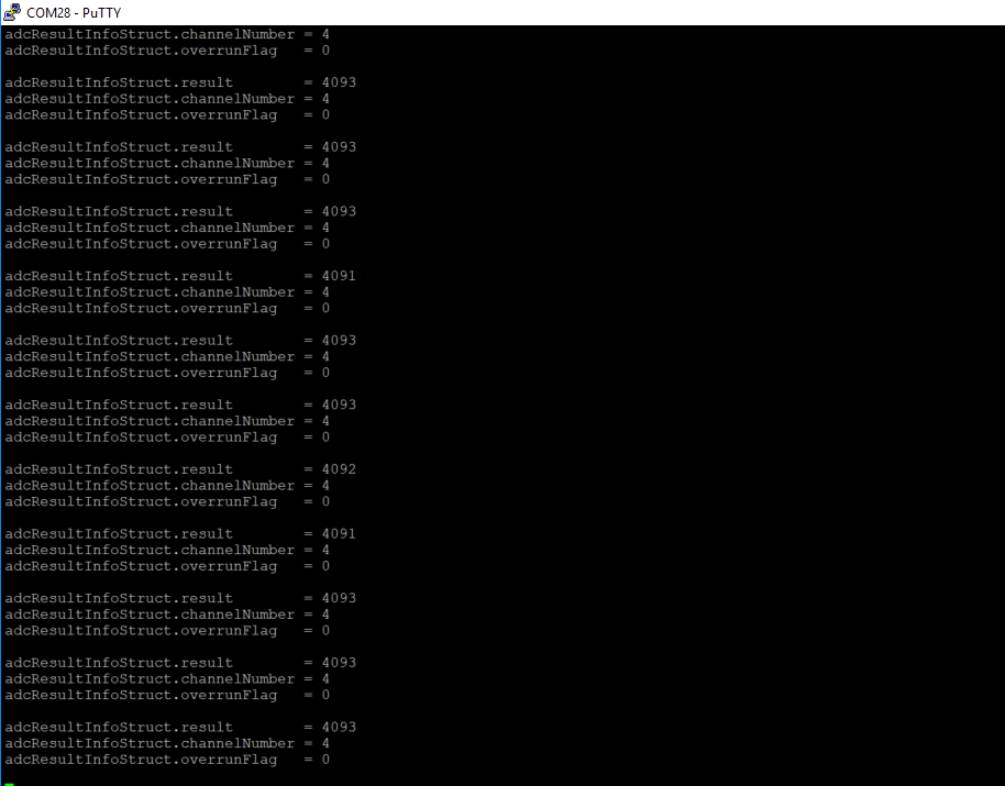

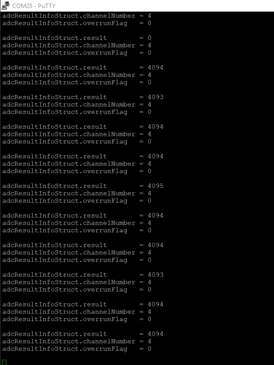

Test1:
when I connect the J12_2 to GND, the sample is all 0 as the following Fig with the code:
Test2:
when I connect the J12_2 to 3.3V, the sample is  as the following Fig with the code:
So no problem for the ADC converter even if using PLL.

xiangjun_rong
Hi, Prasanna,
I have used ADC channel 4(J12_2 on LPCXpresso54808 board, PIO0_16/ADC0_IN4) to test the external voltage, when I connect the J12_2 to 3.3V, the sample is from 4091~4093 as the following Fig.
when I connect the J12_2 to GND, the sample is all 0 as the following Fig.
In conclusion, the ADC has not issue.
