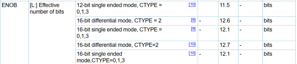

Hi, I cannot find the ENOB of ADC 12bit mode for LPC5528.
What is the ENOB if I use 12bit single ended mode?

Unfortunately, we don't have this value for 12bit ADC, only the 16bits value which can be found in table 36 of the datasheet.
The ENOB can be calculated with this formula:
Where SINAD is the Signal-to-Noise-and Distortion ratio.

Hi nxf54944 , thanks for your answer.
But I think it is impossible to me to do the measurement of ENOB using my simple equipment. ENOB should be provided by MCU manufacturer.
LPC551x have 12bit mode ENOB in datasheet but LPC5528 doesn't have.
Is it possible for NXP to do the measurement for LPC5528?

The ENOB for the LPC551x also applies to the LPC5528. So the ENOB of the LPC5528 in 12 bit SE is 11.5bits.
