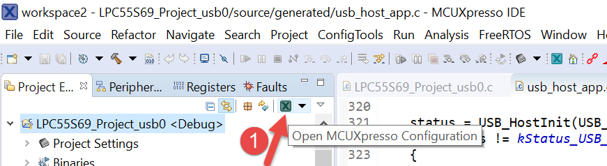

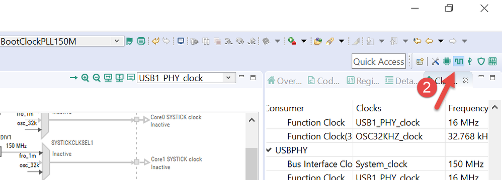

prathap_ponnuch
Hi Jun Zhang,
Thanks for replay and Sorry for the delay.
Here cant able to see clock config setting.Where we need to go and set?
Thanks in advance.
prathap
2,309 Views
ZhangJennie
Follow below steps to go to clock config tool

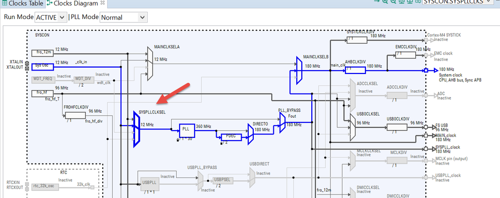

Hi prathap ponnuchamy
You can easily config clock with Clock Config tool integrated inside MCUXpresso IDE.
By default, fro_12M is used as PLL input to provide system clock.
if you want to use external clock as pll input, just config SYSPLLCLKSEL to select clk_in as source. see below.
your external clock is 25M, just config sys osc as 25Mhz, you need make sure PLL output frequency range is between 275MHz-550MHz.

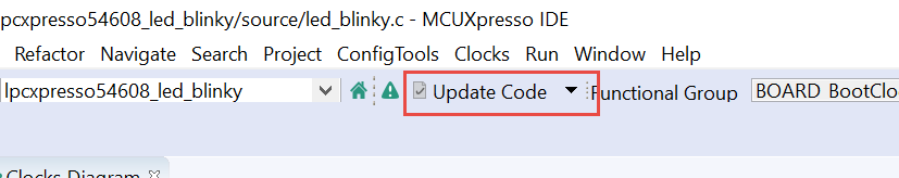

after configuration, don't forget update code:
