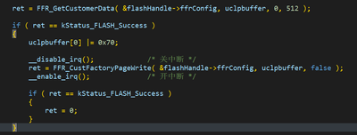

       Our customer will disable ISP mode before booting, below is the code to modify the CMPA register.
       But after running the code, LPC55 will disable ISP and SWD (debug) function.

1>from the code, you can see that I have read the orignal data via the function FFR_GetCustomerData, then change the first byte to 0x70, and then write it back to the flash via FFR_CustFactoryPageWrite. And I
have took a quick look at the original data when debug, there were all 0x00.

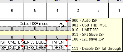

Hello, my apologize I never use it before that function FFR_CustFactoryPageWrite. I saw the CMPA information, and the disabled ISP is on address 0x9E400 and need to put 0x70 to active the 6:4 bits.
So, I reviewed your function FFR_CustFactoryPageWrite your data configuration seems to be well, offset 0 and len 512, and the same with the FFR_CustFactoryPageWrite.
Could you please share me this part of your code to get more details?

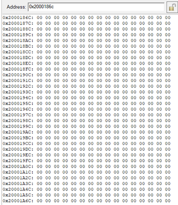

1>the original data is as below:
I have modified the 0x2000186c to 0x70, and then write it back.

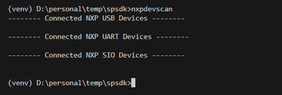

2>I have installed the spsdk, and connect the board via cmsis-dap,but I got a different result from the manual when I use the "nxpdevscan" command:

Pavel_Hernandez
Hello, about the communication with the Blhost you need to use a UART and USB to Serial. I mean connect your board to the PC push the bottom ISP and then Reset to enter in ISP mode.
On the board the debugger has UART interface you can use the same debug link port P6.

I have modified the first byte(offset 0)to 0x70,which means disabling the ISP pin according to the TRM. Could I use the ISP pin to enter the ISP mode?
