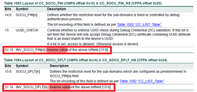

Note that the default value of CC_SOCU_PIN and CC_SOCU_DFLT in LPC55 PFR are all zeros. Therefore, in this case, although SOCU_PIN and SOCU_DFLT are both 0, the bit reverse rule is not met (Figure 3 below). Therefore, all debugging permissions are enabled by default when CC_SOCU_PIN and CC_SOCU_DFLT are all 0.
Figure 3
Note: the distinction between CC_SOCU_PIN(CC_SOCU_DFLT) and SOCU_PIN(SOCU_DFLT). The former with CC_ includes the reverse bit of the latter.
For example, if SOCU_PIN and SOCU_DFLT are set to all zeros and the reverse bit is set to 1, all SWD modules are disabled.

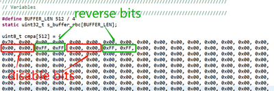

The following uses LPC5506 as an example to configure the CMPA field:
3.1  Disable ISP and SWD
Figure 5
Keep the default CMPA values except for the two highlighted in red in Figure 5.
1) Set BOOT_CFG to 0x70 to disable ISP.
2) Set all SOCU_PIN and SOCU_DFLT to 0, and set all reverse bits to 1. That is, disable all debug accessing subdomains.

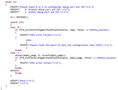

3.3 Code Implementation
Enable or disable the SWD and ISP functions by serial command (1 or 0).
Figure 7
The demo code is attached. This routine has been tested on the LPCXpresso55S06 development board.
