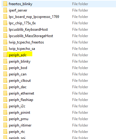

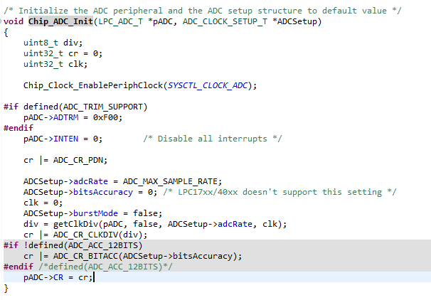

The libraries included in the zip folders I previously mentioned of the LPCOpen already have functions and macros defined that will help you get started. You can follow the example code provided or you can browse these functions within the src folder of the chip folder.
Here for example you have an ACD_init which you can refer to setup this particular peripheral.
Or you can use the ADC example in the same zip LPCOpen folder to base your application on.
