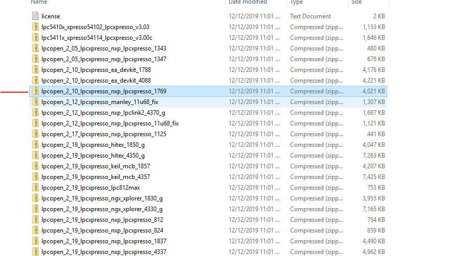

2. The steps found in this thread will allow you to import the example projects provided in the LPCOpen folder.
*Note: For this LPC, since it is an older family the examples will be found in LPCOpen, there is not an SDK builder for this particular chip.
The path to find this folder is C:\nxp\MCUXpressoIDE_11.1.0_3209\ide\Examples\LPCOpen  I recommend to use the following zip folder.
When importing the examples please make sure you have selected the two projects as shown in the thread, if not it will not be able to build with the configurations for the chip.

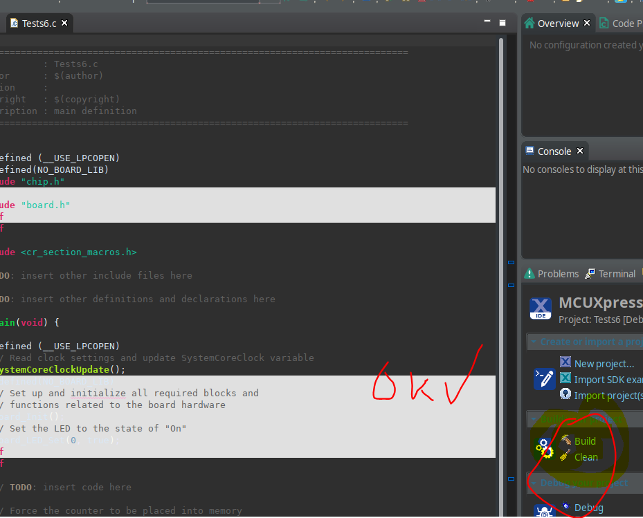

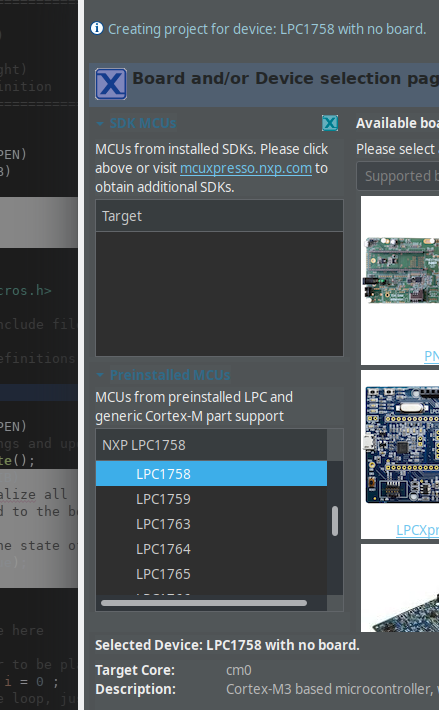

I already have the lpc projects and specifically the LPC1769 zip in my workspace. I start a new project and base it on the LPC1758, the project compiles, but there is "no mcu selected" and the config tool doesn't allow me to do anything.
All ok and compiles with newly created project.
but I still can't set up the peripherals or am I just meant to manual set the registers from defined in the chips user manual?

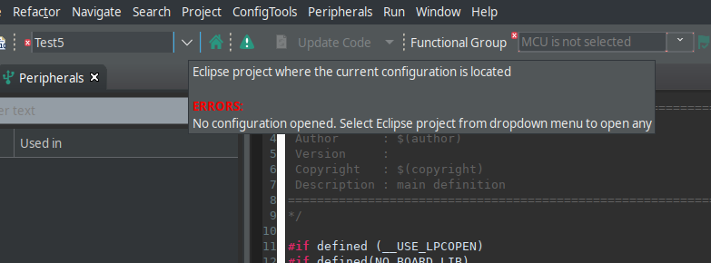

In addition to this When I reopen the project by opening the workspace and then selecting project from the drop down menu I get this error. This means now the "build" link is greyed out.
and the below error is shown.

Ok, thank you for the images. I now understand what is going on.
The LPC17xx is an older family which is not part of an SDK in addition the config tools provided in mcuxpresso ide, such as the pins tools, clocks tool, peripheral tool, etc are not enabled for this part. So you will not be able to use it as you might have done in the past with other microcontrollers.
In this same manner, the build option will be greyed out, because it is not compatible with working with these windows. You should return to the normal code view by clicking the develop button.
