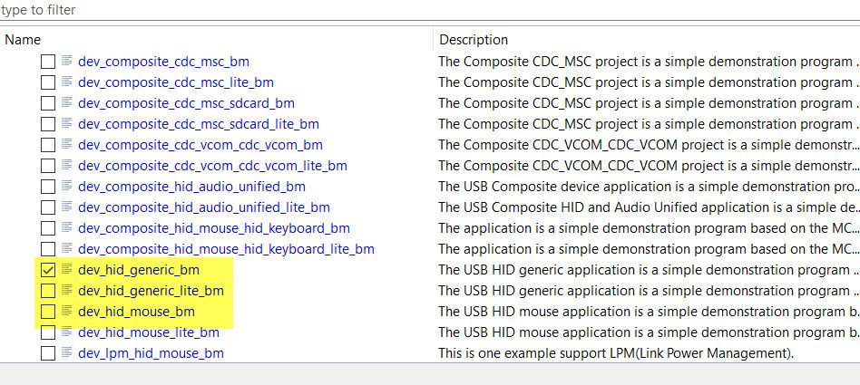

Hello OliveiraNxp,
You can only create a new MCUXpresso project or open a demo, then porting the code from KEIL to MCUXpresso by hand.
Abbout USB_HID drivers, MCUXpresso sdk also has, open a USB_HID demo ,you can find them:
Alice

OliveiraKolNxp
Hi Alice,
I´m trying to find the dev_hid_generic and couldnt find it.
Can you explain the procedure ou send me the download link for it?
Oliveira
Oliveira
12,110 Views
Hello Oliveira,
Please open the link and then refer to my attachment to download,
https://mcuxpresso.nxp.com/en/select
After download, you can find the USB demos under the path:
SDK_2.7.0_LPCXpresso54618\boards\lpcxpresso54618\usb_examples .
Alice
