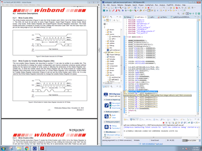

hi i am suraj,
i have tried several times the code of spifi which is present in lpc54628 development board and i couldn't able to find the cs bar high as well the clock itself
i have uploaded the code for further reference and to solve the warnings.
with regards
suraj

ZhangJennie
After you successful initializing SPIFI, once you read or write SPIFI,CS will automatically put CS low and generate spifi clock.
