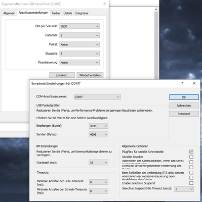

> My conclusion is that the UART-to-USB conversion on the dev board only works up to 230400 baud. Is that correct, or is there some way to make it support higher baud rates?
No, this conclusion is based upon assumptions.
The serial data are tunneled through the USB protocol, and the higher the baudrates, the more fragile the timing balance becomes. Most probably, the issue is with the USB driver on the host PC.
In the device manager / properties, there is an "extended settings" dialog for such serial interfaces, where you can change certain USB parameters, like USB package size or delays.

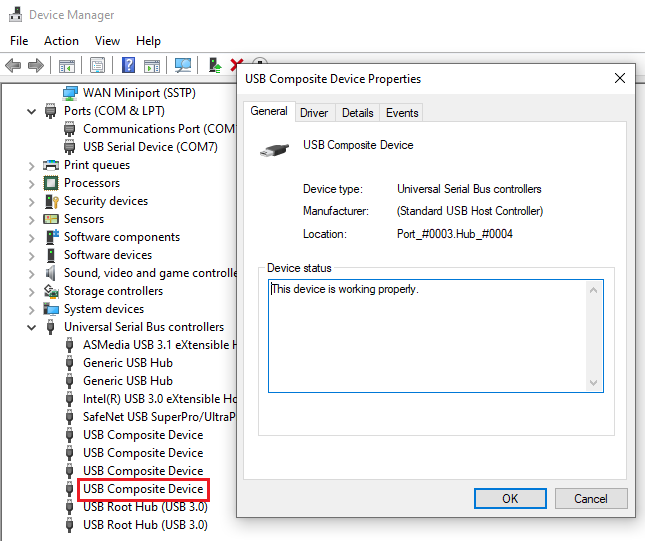

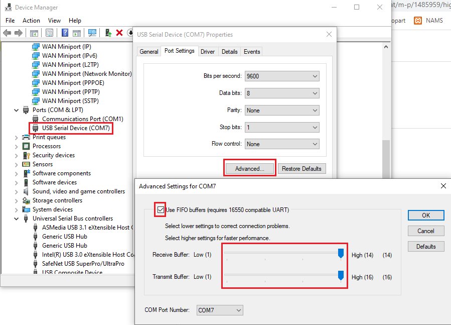

Please provide more detail on where to find these settings.
Are you talking about the Advanced settings for the COM port in Device Manager?
I've tried adjusting everything I could - turning on/off FIFO buffers and changing the size of the receive and transmit buffers.  None of these seem to affect the issue
I didn't find anything adjustable in the corresponding USB controller device in Device Manager
Am I looking in the right places?

Yes, that would be the settings you can influence. On my work PC, it looks a bit different - obviously it depends on the driver. (And it's not in English either ...)
But we (me and my work mates) know a few USB-serial adapter one should never attach during Windows boot-up, or else they throw a blue-screen. Which is to demonstrate, such drivers come in different qualities.
I would take a scope and check the signal on the MCU side at mentioned high baudrates, especially the bit timings. If that looks correct, the problem is on the PC hardware/driver side.
