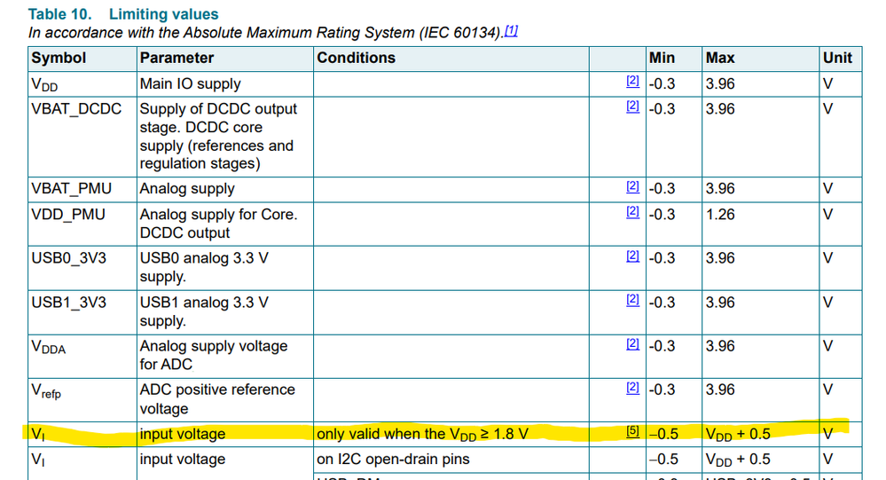

danielholala
Senior Contributor II
Hi there,
I'm currently looking into the product data sheet of LPC55S2x/LPC552x which should also cover the LPC5528.
Regarding pin 25 (USB1_VBUS), the data sheet refers to footnote [8] which states:
"The corresponding VBUS must be connected to supply voltage when using the USB peripheral. USB0_VBUS is not 5 V tolerant pin. "
I'm puzzled. This seems contradictory to what is stated in this thread.
Is this pin 5 V tolerant and more generally, are the other digital input pins 5V tolerant?
I assume not as the data sheet on page 73 shows that Vi maximums is VDD + 0.5 V.
Please advise.
6,413 Views
frank_m
Senior Contributor III
> The pin is 5V tolerant only when VDD is applied at operating voltage level.
I am not sure if that is clear enough.
All operation conditions (like voltage) apply only in a powered state, i.e. VDD applied. In power-off state, any voltage on other pins beyond (usually) 0.3V will be harmful.
