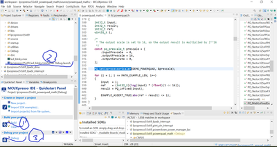

I think this is the procedure:
1)connect the MCU link to the SWD connector on your target PCB, power up your target board and MCU link board
2)pls follow up the step to download code to your target board. The second step is to delete the *.launch file so that the tools can detect the new debug device such as mcu link device. The third step is to detect the device and download code by clicking "Debug" button.
Hope it can help you
XiangJun Rong
