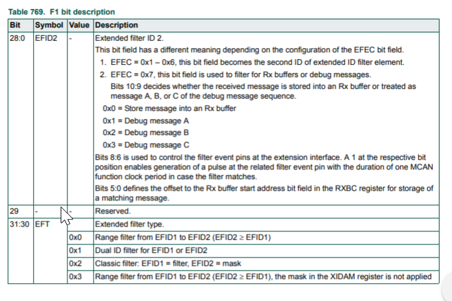

Can anyone post working code for CAN Extended ID filtering with multiple filters?
I'm using LPC54618J512BD208 MCU and started off with the CAN example code in NXP Device Firmware Pack.
I'm able to receive (using Rx FIFO) and transmit CAN messages in & out but only with one filter set.
Expecting some help.
// Rgds, Mani

Hi Manikanta,
This parameter is used to enable more than one filter, if you want to set more than one filter, for example, in the next code:
 /* STD filter config. */
    rxFilter.address = STD_FILTER_OFS;
    rxFilter.idFormat = kMCAN_FrameIDExtend;
    rxFilter.listSize = 2U;
    rxFilter.nmFrame = kMCAN_reject0;
    rxFilter.remFrame = false;
    MCAN_SetFilterConfig(EXAMPLE_MCAN, &rxFilter);
    /*First filter configuration*/
    extendedFilter.efid1 = 0xFFFFFF0;
    extendedFilter.efec = kMCAN_storeinFifo0;
    extendedFilter.efid2 = 0xFFFFFFF;
    extendedFilter.eft = kMCAN_disableORrange2;
    MCAN_SetEXTFilterElement(EXAMPLE_MCAN, &rxFilter, &extendedFilter, 0);
    /*Second filter configuration*/
    extendedFilter.efid1 = 0x1;
    extendedFilter.efid2 = 0xF;
    MCAN_SetEXTFilterElement(EXAMPLE_MCAN, &rxFilter, &extendedFilter, 1);
With this condiguration I set two ranges, one for 0xFFFFFF0 - 0xFFFFFFF, and the other for 0x1 - 0xF, check that the last parameter in the MCAN_SetEXTFilterElement is the filter offset, with this you change where is stored this filter.
I hope this helps you.
Alexis Andalon
