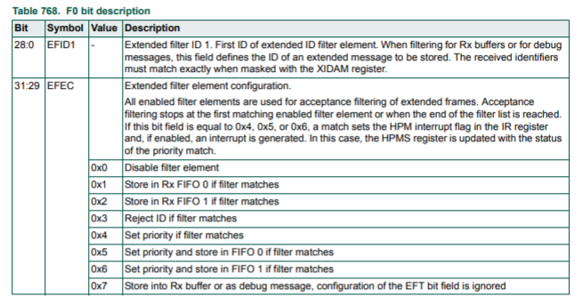

Alexis_A
Hi Manikanta,
If you already have a working example about it, check the 35.15 section of the reference manual, here you can set the filter ID, select where the mesages would be stored and the filter configuration.
If you're using the SDK, you could try with the following code:
    extendedFilter.efid1 = 0xFFFFFF0;
    extendedFilter.efec = kMCAN_storeinFifo0;
    extendedFilter.efid2 = 0xFFFFFFF;
    extendedFilter.eft = kMCAN_disableORrange2;
    MCAN_SetEXTFilterElement(EXAMPLE_MCAN, &rxFilter, &extendedFilter, 0);
Here the filter is set to range, so the messages between 0xFFFFFF0 and 0xFFFFFF would be received.
I hope this helps you.
Alexis Andalon
