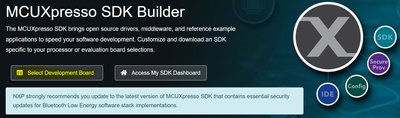

RaRo
Hello @smishra125,

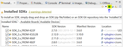

First, download an IDE compatible for creating your project, as MCUXpresso IDE
Second, in MCUXpresso IDE (as @danielholala points out) there is a bunch of examples you could try related with CMSIS, but first you need to download the SDK for your microcontroller; there are two ways:
  1. Trough the MCUXpresso IDE
  1. Trough the MCUXpresso SDK Builder

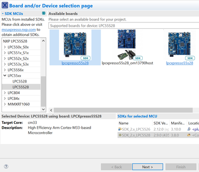

You can access the examples in MCUXpresso IDE as follows:
  1. Click on Import SDK example(s)…
  1. Select the micro or board related with the SDK you download it
  1. Then search for CMSIS examples

danielholala
Senior Contributor II
Have you installed the SDK for your controller? If so, then import an SDK example and have a look at the source code. There are CMSIS driver examples for I2C, SPI and USART interfaces.
