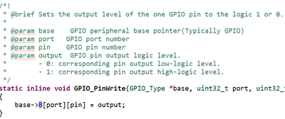

First of all, as an advice I would recommend you take a look at driver fsl_gpio.h and fsl_gpio.c. There you will find functions that work with GPIO. Even if you don't want to use the functions for your application, it is good to have a look and see what the function is doing. For example, you are using B: Byte pin registers for all port GPIO pins for Pin Write, that is good, but look the normal usage of it:
[fsl_gpio.h]
Now take a look to what you are doing: gpio->B[1][LED_BLUE] = (1<<LED_BLUE);
Your code should be something like: gpio -> B[1][LED_BLUE]=1; or gpio -> B[1][LED_BLUE]=0; depending on the output you want to have at that moment.

> gpio->B[1][LED_RED] = (1<<LED_RED);
Assuming the access to the gpio.B struct really translates into the proper peripheral registers - I cannot see how this code should effect a toggle.
You are always setting the bit.

Your code always sets the respective outputs, which has a visible effect only the first time.
To toggle the LED, you need to alternatively turn it on and off.
Either directly by reading the current state back, or indirectly by a cycle counter.
