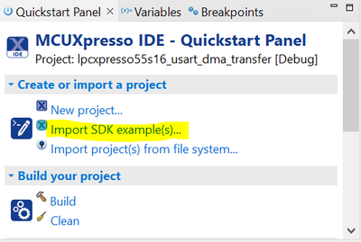

RaRo
Hello @smishra125,
First, download an IDE compatible for creating your project, as MCUXpresso IDE
Second, in MCUXpresso IDE (as @danielholala points out) there is a bunch of examples you could try related with CMSIS, but first you need to download the SDK for your microcontroller; there are two ways:
  1. Trough the MCUXpresso IDE
  1. Trough the MCUXpresso SDK Builder
You can access the examples in MCUXpresso IDE as follows:
  1. Click on Import SDK example(s)…
  1. Select the micro or board related with the SDK you download it
  1. Then search for CMSIS examples
Third, if you are searching for more information, I recommend you take a look to the following links: Overview CMSIS, and CMSIS: Cortex Microcontroller Software Interface Standard.
Regards, Raul
