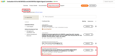

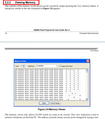

Yes, you can use 56800E Flash Programmer User Guide to read memory from 56F8323.
Please download the 56F8XXXFP software:
EVK for MC56F832x and MC56F812x DSCs | NXP Semiconductors
Then open the file 56800EFPUG and follow the steps of section “2.2.3 Viewing Memory”:
