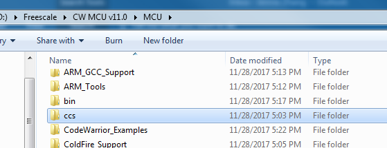

CodeWarrior for DSC v8.3 doesn’t support 64bit Windows 10 and Windows7 naturally, because the ccs driver included in CodeWarrior v8.3 package only support old windows platform.
We will explain how to configure the USB TAP run control interface on Windows 7 and Windows 10 64-bit for those using CodeWarrior development tools based on the Classic IDE rather than the Eclipse IDE.
This workaround was tested and verified on Windows 7 64-bit and Windows 10 64-bit  for CodeWarrior DSC V8.3.
Installation steps:
  •        Install CodeWarrior v8.3 on a Windows 7 or Windows 10 64bit system.
At the end of installation, three or four error messages appear regarding a problem installing the USB drivers. Ignore these errors.
  •        Acquire latest ccs driver from CodeWarrior eclipse.
Install CodeWarrior for Microcontrollers-Eclipse IDE 11.0|NXP  to a computer, Copy ccs folder from CodeWarrior v11 installation folder to CodeWarrior v8.3 install folder, replace original ccs folder.
  •        Uninstall CodeWarrior eclipse v11. This step is optional.
Now you can use CodeWarrior v8.3 on new windows platform.
Please NOTE: Officially CodeWarrior 8.3 was not designed for win7/10.  This doc is just a personal technical sharing.
If user meets windows compatible issue of 8.3 on win7/10. Please move to CodeWarrior 11.
