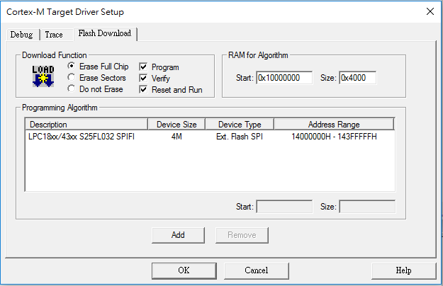

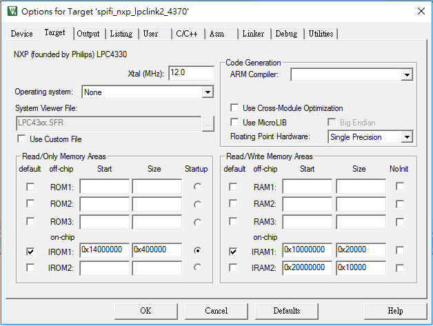

1. I have two LPC-Link-II, one of Debug and another of Target, tried download program is OK.
2. I designed one board, uC: 4370 LBGA256, flash: S25FL128L.
I tried to download program via JTAG, but get message "Flash Timeout. Reset Target
and try it again".
uVision V5.24.2.0
Debug: LPC-Link-II CMSIS-DAP
I check pin define is correct of the 4370 LBGA256 to S25FL128L, am I missing anything?
Can someone please help me?

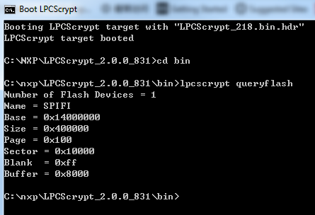

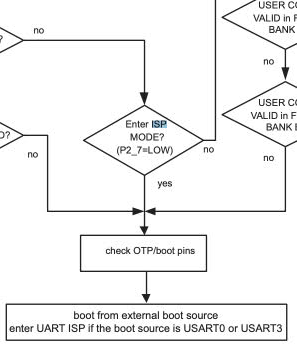

I'd like to illustrates the procedure of testing below.

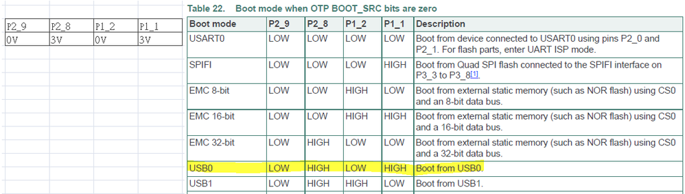

1. Assure the staus of P2.7 is high and configure the boot pins to force the MCU to enter USB ISP mode.
Fig 1
2. Click the Boot LPCScrypt.

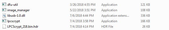

Fig 2
3. Input cd bin to transfer to bin file

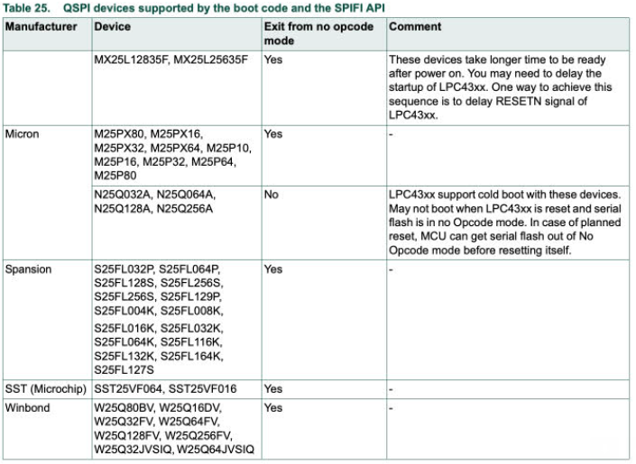

4. Input lpcscrypt queryflash to recognize the flash.
Fig 3

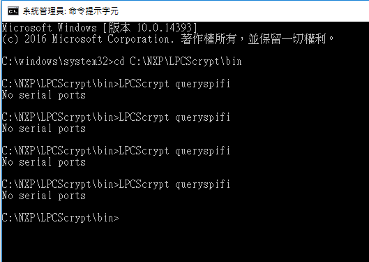

jack_chen
Hi NXP Support:
I following your provide steps test my design card, but get message "No serial ports".
1. I have keep ISP P2_7 as low voltage.
2. I checked boot ping and boot mode is right.
3. My designed board's USB its the same as LPC Link2.
Do you have any suggestions for me?

jeremyzhou
Hi Jack Chen,
Firstly, using LPCScrypt to recognize the SPIFI flash to confirm whether the hardware connection is right.
If the S25FL128L is able to be recognized, definitely, it represents that the debug issue about the compatibility between the flash algorithm and the S25FL128L.
Please refer to the attachment, and give a shot.
TIC

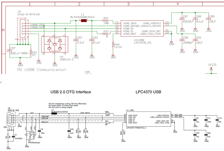

jack_chen
Hi NXP Support
I can find the DFU device in Device Manager after plugging the LPC Link2.
But, I can't find the DFU device in Device Manager after plugging the my designed one board.
The LPC4370 boot ROM support S25FL128L?
5,381 Views
jeremyzhou
Hi Jack Chen,
Thanks for your reply.
Actually, the chip will be enumerated as DFU class device after attaching the USB port when the chip boot from USB, it's nothing with the external QSPI, as the code is stored in ROM area.
I think you should use the following steps to recognize the external QSPI instead of click Boot LPCscrpt directly.
Untitled1.jpgFig 1
1. Open command window
2. Input cd ~\bin to transfer to bin file
Fig 2
3. Input LPCScrypt queryspifi‍‍‍‍‍‍ to recognize the flash.
TIC
