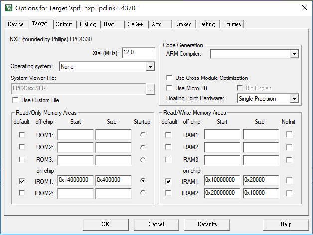

1. I have two LPC-Link-II, one of Debug and another of Target, tried download program is OK.
2. I designed one board, uC: 4370 LBGA256, flash: S25FL128L.
I tried to download program via JTAG, but get message "Flash Timeout. Reset Target
and try it again".
uVision V5.24.2.0
Debug: LPC-Link-II CMSIS-DAP
I check pin define is correct of the 4370 LBGA256 to S25FL128L, am I missing anything?

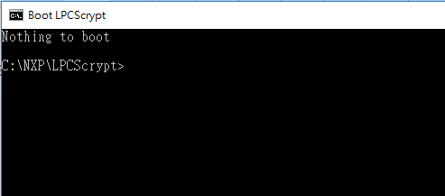

I'd like to illustrates the procedure of testing below.
1. Assure the staus of P2.7 is high and configure the boot pins to force the MCU to enter USB ISP mode.
Fig 1
2. Click the Boot LPCScrypt.
Fig 2
3. Input cd bin to transfer to bin file
4. Input lpcscrypt queryflash to recognize the flash.
Fig 3

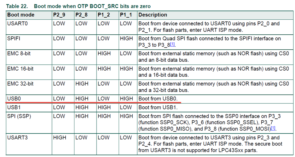

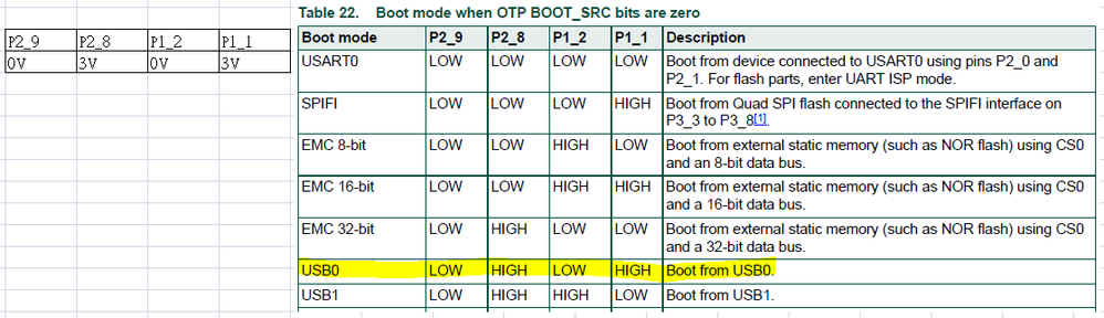

Hi NXP Support:
I following your provide steps test my design card, but get message "No serial ports".
1. I have keep ISP P2_7 as low voltage.
2. I checked boot ping and boot mode is right.
3. My designed board's USB its the same as LPC Link2.
Do you have any suggestions for me?

jack_chen
Hi NXP Support
I using LPCScrypt to recognize the SPIFI flash to confirm on LPC Link2. Test result: connect is right.
But I try my designed one board encountered can't connect to LPC4370.
1. I checked boot ping and boot mode is right.
2. I use USB connect, but device manager haven't find LPC device on my laptop.
About LPC4370 USB boot, am I missing anything?
LPCScrypt tools only support LPC Link2?
Thanks.
