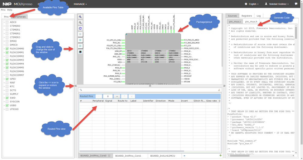

The Pins Tool consists of several views.
Using the Pins Tool
The Pins Tool is designed to configure routing of signals from peripherals either to pins or to internal signals.

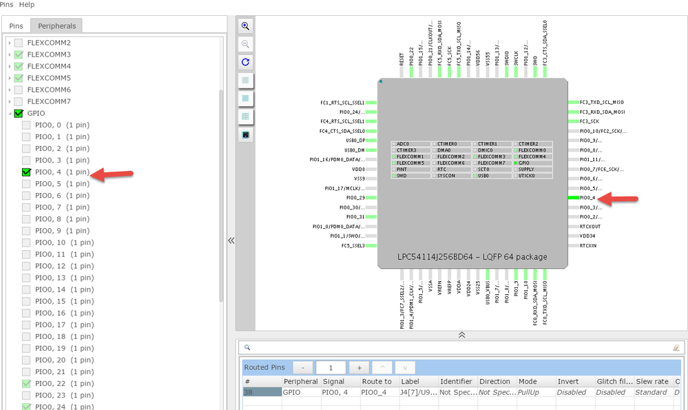

To define routing path, first select a peripheral, then select the signal, and finally select the pin.
1. Select a peripheral for example GPIO. The following image illustrates the filtering controls in the Pins view.
2.  Route the selected Signal to the desired pin. It is possible to easily identify routed pins/peripherals in the package using highlighting.
By default, the current selection (pin/peripheral) is highlighted in the package view.
• Red indicates that the pin has an error.
• Green indicates that the pin is muxed or used.
• Light grey indicates that the pin is available for mux, but is not muxed or used.
• Yellow border around the pin such that the other color is still visible indicates that the pin is selected. For example, by peripheral or by pin.

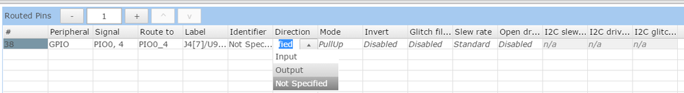

3. Select one of non-conflicting/available pins. Once you have selected Peripheral, Signal, and Route to, the pin configuration is done. Later, it is also possible to configure the pin electrical features. Use the table drop down menu to configure the pin. To configure pins, start from left to right – select the peripheral first, then select required signal, and finally select the routed pin.
The italic value indicates that the value is not configured and it shows the after-reset value and no code is generated, so the configuration relies on the after reset value or the values configured from the different functions.

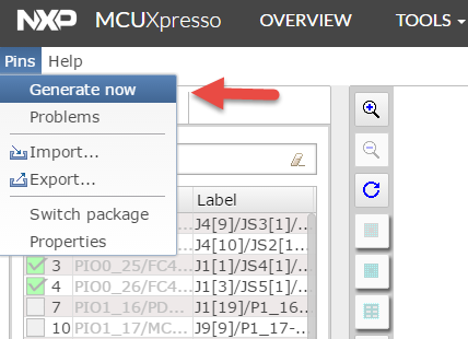

The tool generates source code that can be incorporated into an application to initialize pins routing. The source code is generated automatically on change or can be generated manually by selecting the main menu Pins > Generate Now.
The generated code is shown in the Sources tab on the right window. It shows all generated files and each file has its own tab.
It is also possible to copy and paste the generated code into the source files. The view generates code for each function.

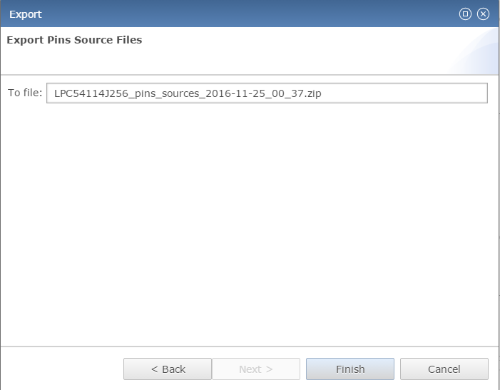

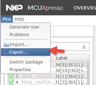

In addition, it is possible to Export generated source using the Export option.
1. Select Pins > Export
2. Click Next.
3. Select the name of the zip file and click Finish. Your download should automatically begin.
