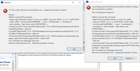

MCUXpresso IDE v11.0.1, incorrectly only supports silicon revision 1B debug session requests and cannot silicon to revision 0A parts in some situations. When connecting LPCXpresso55S69 Revision A1 board, you may have connection error like this:
NXP released an MCUXpresso IDE v11.0.1 LPC55xx Debug Hotfix1 for this issue. Please follow the steps to fix the issue below if you have to use IDE v11.0.1 with silicon revision 0A; however it is recommended to update to the latest version of the IDE instead of taking this approach:

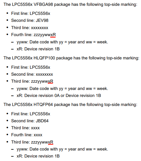

The silicon revision info is marked on the chip and board revision is marked on the board silkscreen. For silicon revision marking information, please consult LPC55S6x Data Sheet section 4. Marking . Below is an example of silicon revision marking information where revision is highlighted in red:
The user application can also get the silicon revision through chip revision ID and number: SYSCON->DIEID:
