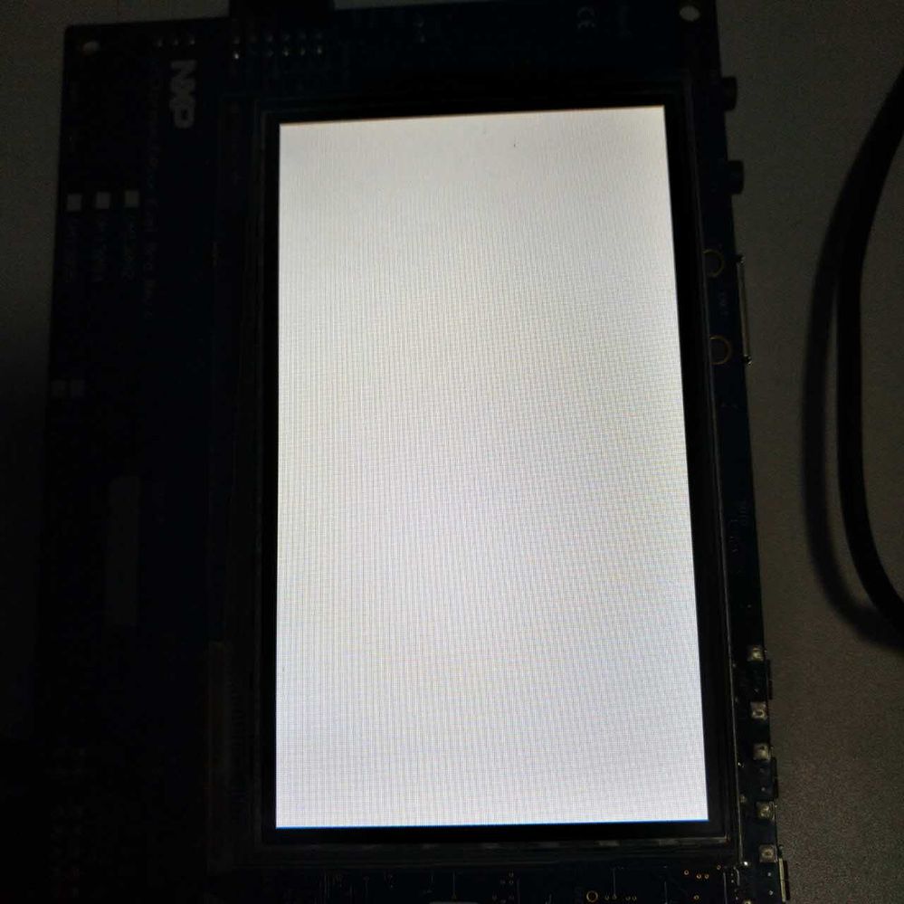

Earlier this month, I got a chance to experience OM13092. Today, I received this amazing Development Board. But at the same time, I also found a white screen phenomenon, the system does not work. Unfortunately I haven't had time to analyze what is causing this problem.
Steps of this problem are: long press the Reset button for 3 seconds or so, then quick short press several times.
check backside JP1,it should be open
