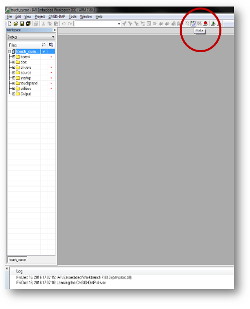

Once the workspace is loaded, you will see the project files on the left.  Along the toolbar the first highlighted item is 'Build' select it.

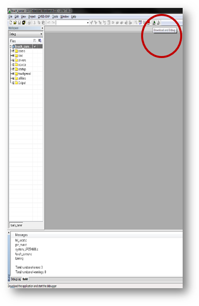

Once your console shows no errors you can select the 'Download and Debug' a few icons to the right of 'Build'

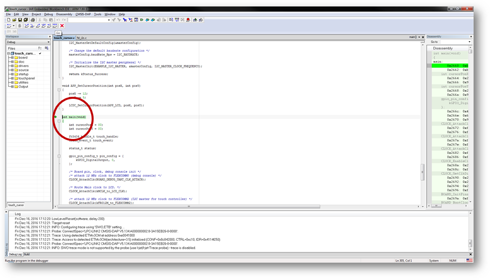

Your debug session will start and will look like the following window.  Once it opens 'touch_cursor.c' and has a green arrow next to the main function you can select 'Go'

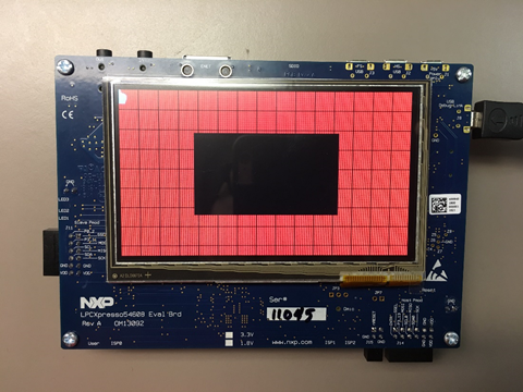

After you have successfully flashed the board with this demo you will see the following on your board.
This demo utilizes the touch interface on the screen to read where you are touching and updates the cursor position to the last known location.
