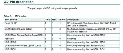

There are two methods to enter ISP mode:
  1. Method 1: Enter ISP mode to upgrade the application during power on
On the hardware side, configure the ISP0~2 pins before power-on or reset, and the MCU enters ISP mode to upgrade the application. The pin configuration method is as follows:
Figure 1.

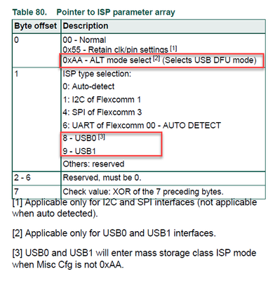

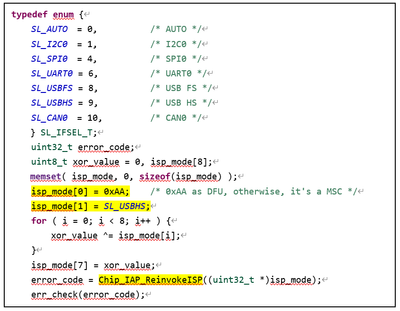

Select the application upgrade mode by modifying byte 0 and byte 1 of the ISP parameter array. The key code is as follows
Figure 3.
There are 3 key point we need to pay attention in Figure 3:
-When isp_mode[0] is configured as 0xAA, it is DFU mode, otherwise it is MSC mode (for example, isp_mode[0] is configured as 0xFF).
-When isp_mode[1] is configured as 8, USB FS is used, and when it is configured as 9, USB HS is used.
-Enter the ISP mode through the Chip_IAP_ReinvokeISP function.

  • Modify the relevant code in Figure 3, as follows:
isp_mode[0] = 0xAA; isp_mode[1] = SL_USBHS;

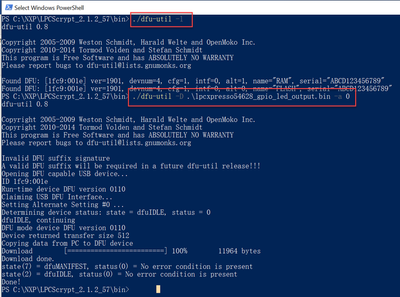

Build and download the application to the MCU, power on again, and connect USB1 to the computer. Here
  • Enter the dfu-util tool directory and copy the .bin file to the current directory.
Use the command: ./dfu-util -l   Find the DFU devices.
Use the command: ./dfu-util -D .\lpcxpresso54628_gpio_led_output.bin -a 0
Download the lpcxpresso54628_gpio_led_output.bin file to the device with alt number 0. Alt0 is "FLASH", alt1 is "RAM", and the specific operations are as follows:
Figure 4.
After downloading the application successfully, reset the MCU and observe the blinking phenomenon of the LED on the development board.

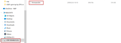

Build and download the application to the MCU, power on again, and connect USB1 to the computer. You will found another disk in my computer, as follows:
Figure 5.
Then do the following to update firmware:
-Remove the original firmware.bin in the CRP DISABLD disk.
-Rename the application (for example, lpcxpresso54628_gpio_led_output.bin) to firmware.bin.
-Copy the application firmware.bin to the CRP DISABLD disk.
-Reset the MCU, if the LED is observed blinking, it proves that the application has been successfully upgraded.
Note: The application must be renamed, and the rename cannot be performed in the CRP DISABLD disk.
