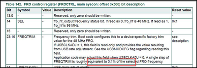

The internal clock frequency is affected by temperature, MCU frequency and other factors. The FRO control register can calibrate the internal clock, as follows:
The FREQTRIM register value ranges from 0 to 255, and each adjustment step is about 0.1% of the internal clock frequency. There is no precise formula to express the relationship between the FREQTRIM value and the FRO frequency. The ideal FREQTRIM value can only be determined by adjusting FREQTRIM in code and observing FRO output waveform with oscilloscope.

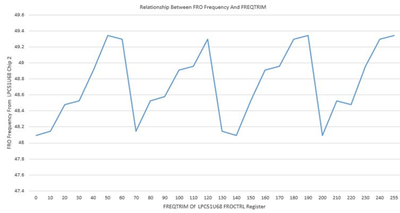

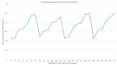

The following is the test result. It shows how FRO frequency varies with FREQTRIM increasing from 0-255.
Test result of first development board:
Test result of second development board:
The following two points can be seen from test results:
- There is no linear relationship between the FRO clock frequency and the FREQTRIM register value, and there is no precise formula to express the relationship between them;
- Even for chips of the same part number, the internal clock frequency changes are slightly different, with the FREQTRIM register value changing, but the trend is same.
Therefore, there is no precise formula to guide internal clock frequency calibration. You can only adjust the FREQTRIM register value repeatedly, just like adjusting the focus of a projector. Use an oscilloscope to check the frequency of the internal clock pin to find the most suitable FREQTRIM register value.

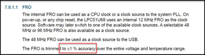

The following is the FRO clock accuracy described in LPC51U68 User Manual, which is ±1%:

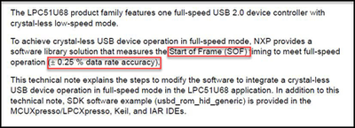

For Full Speed USB, the USB data transmission accuracy requirement is ±0.25%, and the FRO clock accuracy is not satisfied. NXP provides a software solution to calibrate FRO by measuring the first packet of frame (SOF), which can meet the transmission accuracy in Full Speed mode.
The solution download link is as follows:
https://www.nxp.com/docs/en/application-note/TN00035.zip
