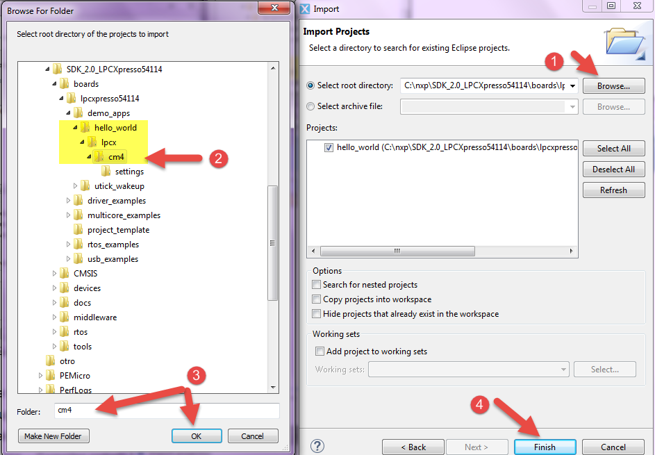

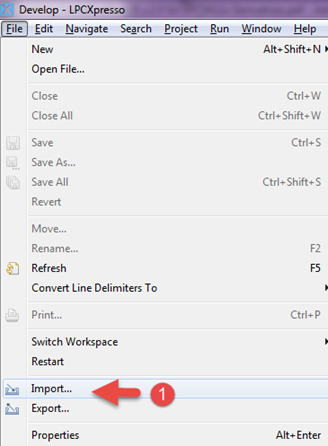

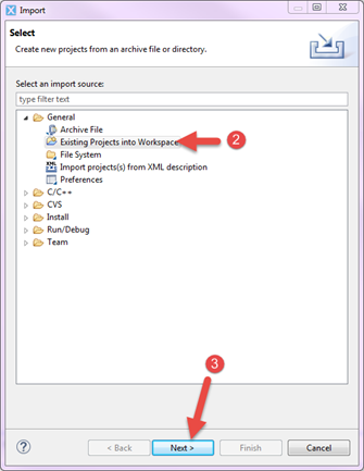

3. Select "File -> Import" from the LPCXpresso IDE menu. In the window that appears, expand the "General" folder and select "Existing Projects into Workspace". Then, click the "Next" button.
4. Click the "Browse" button next to the "Import from file:" option, and point to the example application project, which can be found using this path:
<install_dir>/boards/<board_name>/<example_type>/<application_name>/lpcx/cm4
For this example, the specific location is:
<install_dir_SDK_2.0_LPCXpresso54114>\boards\lpcxpresso54114\demo_apps\hello_world\lpcx\cm4
Then Click the "Finish" button.

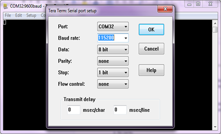

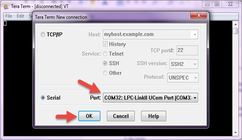

8. In the Windows operating system environment, open the terminal application on the PC and connect to the debug serial port number. For this example it is used Tera Term.
Configure the terminal with these settings:
115200
No parity
8 data bits
1 stop bit

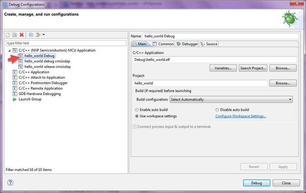

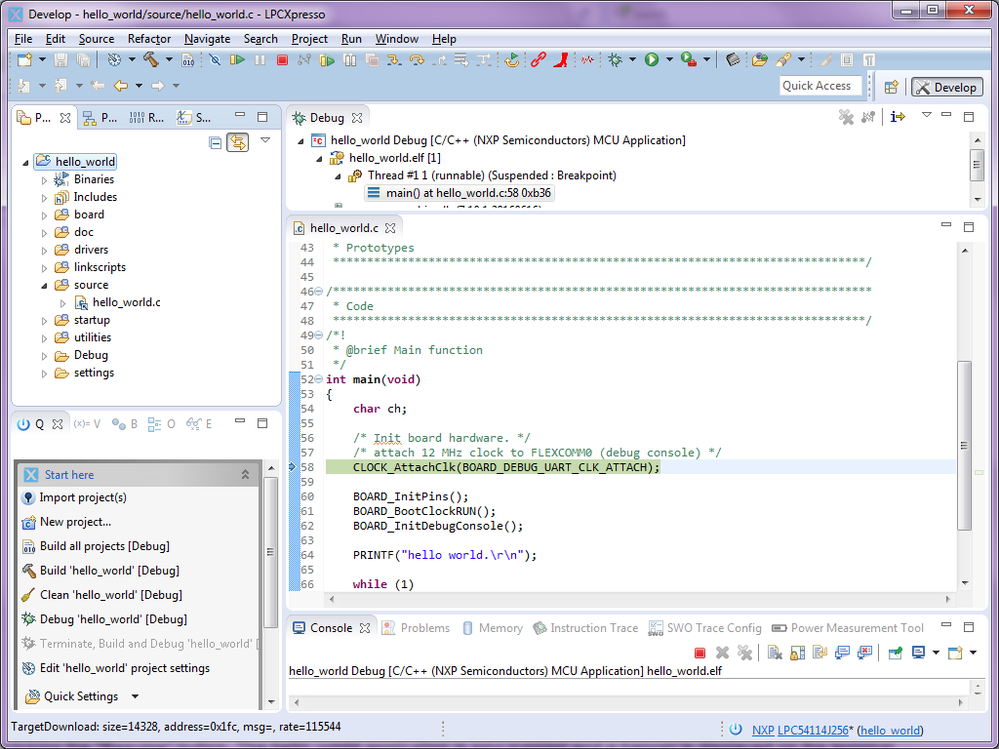

9. In LPCXpresso IDE, click on “Debug Configurations”. In the Debug Configurations dialog box, select the debug configuration that corresponds to the hardware platform you’re using. In this example, select is the CMSIS-DAP option under C/C++ (NXP Semiconductors) MCU Application.
10. After selecting the debugger interface, click the "Debug" button to launch the debugger.

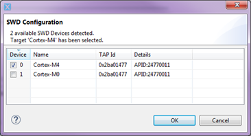

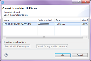

11. Additional dialog windows may appear to select LPC-INK2 CMSIS-DAP emulator and core in case of multicore derivatives. Select it and click the "OK" button. Then select the Cortex-M4. The application is downloaded to the target and automatically run to main():

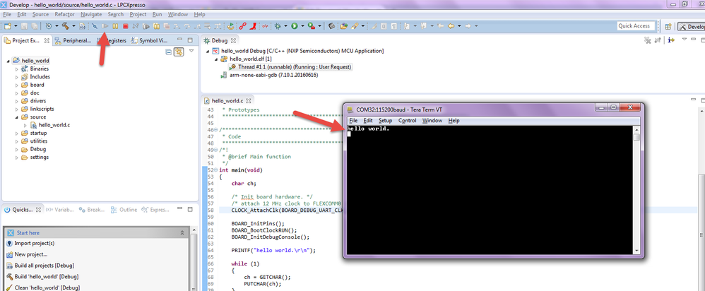

12. Start the application by clicking the "Resume" button. The hello_world application is now running and a banner is displayed on the terminal.
Enjoy!!
