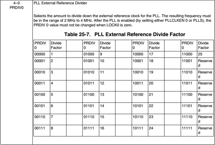

Hi, I want to change the K64F system clock to 100MHz. What files should I change to do it? I am using KDS3.0+KSDK1.2.0 without PE.
Many thank!

Hello Gloria,
The FRDM-K64F contains an external reference of 50 MHz provided by the Ethernet Phy which is used to feed the MCU. As you can see in the image below it is divided by a factor which usually is configured as PRDIV = 0x13 to divide the external reference clock by a factor of 20 to feed the PLL with a 2.5 MHz signal. The PLL internally multiplies the frequency by a factor defined by VDIV0 which usually is configured as 0x18 to multiply by a factor of 48 to get 120 MHz. Since you want a 100 MHz output you need to modify this factor to 40 to get that frequency so you need to configure VDIV0 = 0x10.
So, what you need to do is to change that value in the KSDK configurations. In the file board.c is defined an structure called clock_manager_user_config_t g_defaultClockConfigRun which contains these configurations.

Change the value for the field vdiv to 0x10 and you will obtain a 100 MHz core clock.

gloria
Hi Earl,
Could I change the value of .div0 by switch on the board when the program is running? I want to change the frequency of bus clock when the program is running. Many thanks!
Gloria
3,213 Views
EarlOrlando
Senior Contributor II
Yes but you need to call the function BOARD_ClockInit() again.
Earl.
3,213 Views
gloria
Hi Earl,
Thank you very much! I have solved this problem accourding your instruction!
Gloria
