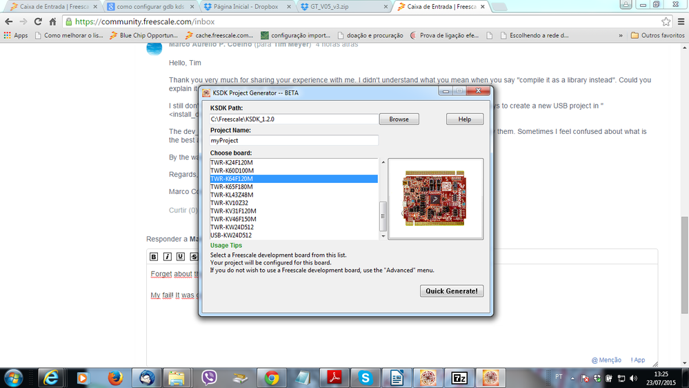

By the way, I didn't find the Project Generator in FRDM-K64F Quick Start Package.

Forget about the SDK Project Generator, Tim!
My fail! It was on the last page of the step by step guide. But I just installed it and it looks like the "Advanced" menu is not showing up. I will communicate this in original post in this Community.

The new version of project generator is being tested with the Advanced configurations enabled, but right now I don't have a release time estimate. As soon as I get some news from development team I will let you know.
