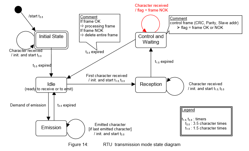

I'm not 100% sure about this.  However, I have been running my code that is expecting a 17 byte Modbus RTU packet, and it very rarely works.
I have a MQX Lite task running the following Modbus FSM:
In each the Reception and Control and Waiting states, I read in data using UART_DRV_ReadDataBlocking and pass 1ms for the timeout.  I'm using 1ms as a rough estimate of the 750us interbyte delay required by the Modbus spec for baud rates > 19200 (I am currently using 38400).
If I send a command that is <= 8 bytes, the command is handled properly the majority of the time.  However, when I send a command that is 18 bytes, it almost never works.  My code always detects the interpacket delay (1750us) after receiving 8 bytes.
Just as an extra test, I have kept reading the RX buffer with UART_DRV_ReadDataBlocking, and the remaining 10 bytes that I am expecting are never read out of the FIFO.  The end result is that my modbus receive buffer has all 0s after the 8th byte and then the CRC check fails.
I'm wondering if I have missed something or am misusing the function.  I know that I have been told that UART_DRV_SendDataBlocking is poorly named and doesn't actually block until the data goes out of the UART TX pin.  I don't see anything in UART_DRV_ReadDataBlocking that suggests the same.
I went ahead and modified my FSM to do the following: keep trying to read bytes and stuff them into a buffer when successful:
case Receiving: {     while( true) {         int ret = UART_DRV_ReceiveDataBlocking( _rs485_instance, &rx, 1, INTERBYTE_DELAY); // INTERBYTE_DELAY is 1         if( kStatus_UART_Success == ret) {             rxbuff[index++] = rx;         }         if( index == 17) {             int i = 0;             i += 2;         }     } ...

I have used MODBUS RTU on various Kinetis parts in many products, where the RTU reception is detailed in the following two documents:
- utasker.com/docs/MODBUS/uTasker_MODBUS.PDF see page 27
- utasker.com/docs/uTasker/uTaskerUART.PDF see page 14
I would suggest the simplest and most accurate method is to use the Rx without FIFO operation so that you get an interrupt per character to control the interspace recognition. For example, add a callback to the standard interrupt that puts the received character to a buffer.
I use this callback to retrigger a 1.5T timer
When this timer fires I then start a 2.5T timer
If there is a character received before this fires it is invalid and the complete frame should be discarded (this is missing from your diagram but is specified by RTU).
If the 2.5T timer fires (3.5T in total) it is a valid frame termination and then your task can simply be scheduled to handle the message in the buffer.
For Kinetis projects I tend to use PITs for accurate timers (accepted 750us for >= 19'200 Baud or more accurate if preferred for > 19'200 Baud) since these usually allow 4 RTUs to operate in parallel. When semi-duplex RS485 is involved I also use the same PIT for RTS timing (descriptions also in the docs) for devices (like KL or KE) which don't do RS485 timing in HW.
Basically I wouldn't use FIFOs since this can greatly obscure timing and I would avoid doing any low level protol operation at the task level. The operation is very simple for an interrup callback and you would need a very high priority task to get close to its accuracy, which would be a waste of resources.

Well, this is progress.  But now I'm back to studying your code snippets.  I made a dumb mistake which is now really obvious.  I disabled the RX FIFO and then ended up using the RX callback (which is essentially the RX ISR) to handle one byte at a time.  I implemented the Modbus FSM in the ISR.  And it looks like it works!  My 17 byte command was received properly.  The problem -- because I evaluate the interbyte and interpacket delays only on incoming data, this means I can't detect the end of one packet until I start transmitting the next.  :smileyhappy:
So I need to have at least a separate timer that can signal at T3.5 to allow the packet to go through.  At a glance, it looks like you're signaling at T1.5 and T3.5.
