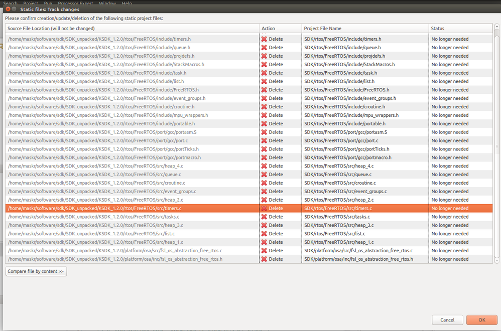

If I select bm from PE then it works, but if I change to FreeRTOS then the variable "start_app" will never be true and start the virtual com app(main.c line 387). I think the problem is in the os abstraction file which PE is changing when generating code.
When changing from FreeRTOS to bm:
When changing from bm to FreeRTOS
I have attached my project if you would like to see it.

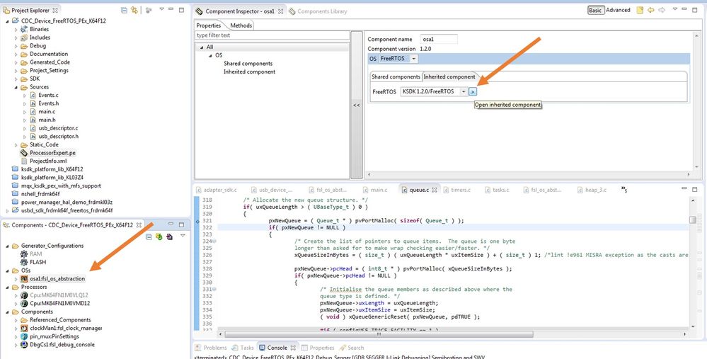

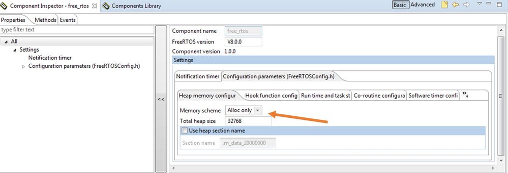

I've already noticed this situation, I also made a project to use PEx + FreeRTOS + CDC Example for FRDM-K64F in one project, but i got some errors on malloc function in FreeRTOS' abstraction, that is why in my project, device could not start. (malloc always returned NULL pointers), this is done due current heap scheme in FreeRTOS. (For More information, please check this post:Malloc not working in a task  )
Please, try next modification:
Go to osa component and then to inherited component related to FreeRTOS:
Change Heap scheme and heap size as shown below:
After this, example code should work without problems.
I attach project created for FRDM-K64F.
Isaac
