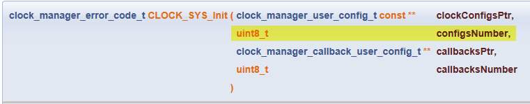

Before switching clock configurations you need to call CLOCK_SYS_Init(), which actually asks for the number of configurations in the second parameter:
So in your case this would be something like this:
CLOCK_SYS_Init(g_clockManConfigsArr,
               FSL_CLOCK_MANAGER_CONFIG_CNT,
               g_clockManCallbacksArr,
               FSL_CLOCK_MANAGER_CALLBACK_CNT);
