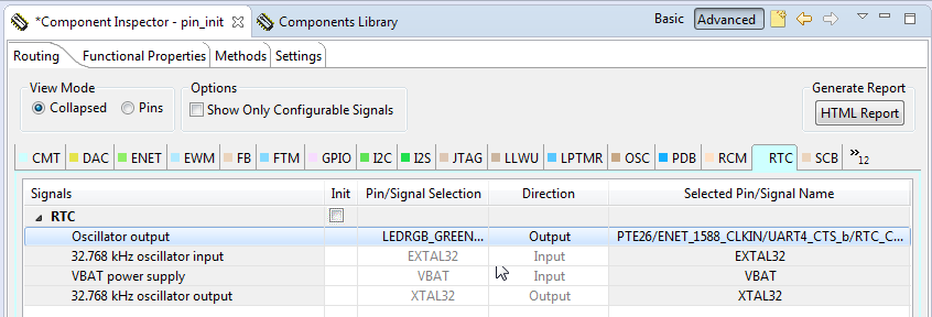

LoL with the toggling LED.  Sorry about that.  In PE for the pin_init:PinSettings Component you can enable the RTC_CLKOUT on PTE26/LEDRGB_GREEN.
Default config
Modified config:
To clear the setting I highlighted it and then used "Delete" key followed by "Enter/Return" key.
