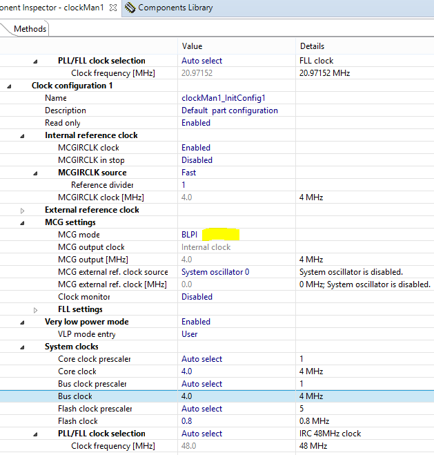

I'm using KDS 3.2,  KSDK 1.3.0, PE with an MK02FN64VLH10 in 64 pin package with a custom PCBA .
I want to set up clocks for BLPI mode to get in the VLPR mode. Here are the PE selections (note it is BLPI mode)
Here are the PE selections (note it is BLPI mode)...The clocks out look correct to enter the VLPR mode, correct??.

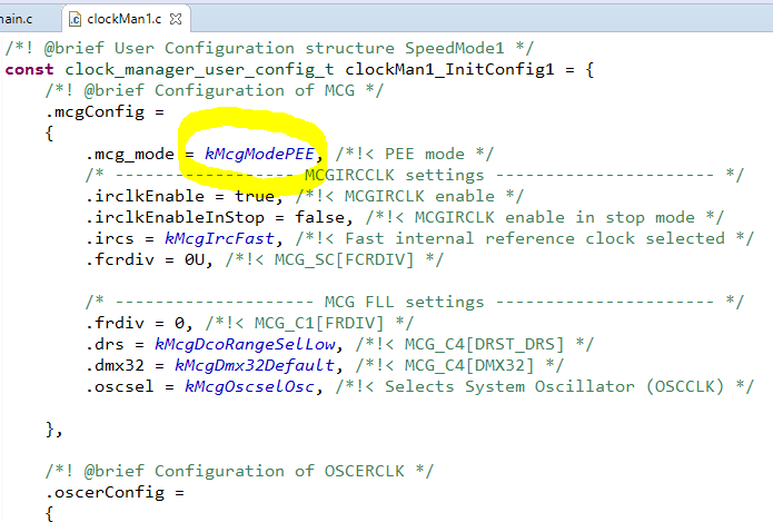

Problem is the PE generated code shows the selected mode as:
The PEE mode is not on the PE MCG mode selection list.
Searching the project for kMcgModePEE, All references to it are greyed (between #if  ....and ..  #endif) except in the enum for _mcg_modes.
Any help would be greatly appreciated.

Hello Rande Newberry:
I reproduced your settings and this must be a Processor Expert bug. I will report this to PEx team, sorry for the confusion.

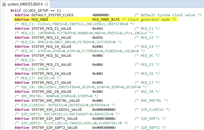

Notice however that those structures are generated for run-time clock configuration changes, but the MCU should still be initialized in BLPI mode. The file system_MK02F12810.h has the clock initialization macros, and you should see something like this:
In case you need to change the clocks at run-time then the structure will indeed be wrong. As workaround you can change it to BLPI:
And disable code generation for the fsl_clock_manager component (right click on the component to open context menu):
