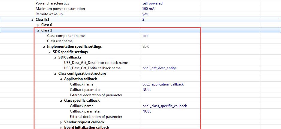

  • Configure fsl_usb_descriptors as follows:
    • Class Code:
    • Class list will be 1 by default, so you need to add another class (set to 2). Class 0 will handle MSD configuration and Class 1 will allocate CDC configuration.
    • Modify Class 1 as shown below:
    • Set 2 interfaces to this class (One is used for control and other for data), configure them as follows:
    • Class Code:
  • Generate code. Now we proceed to do some modifications on generated code (For next modifications, you can use CDC_MSD example available in KSDK 1.3), I am adding a preprocessor definition to identify the added code.
