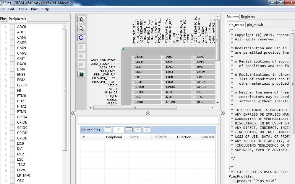

Hi, Christie,
I just have a try, I can download the FRDM-K64F, I paste the screenshot. The preference menu setting is the same as yours.
XiangJun Rong

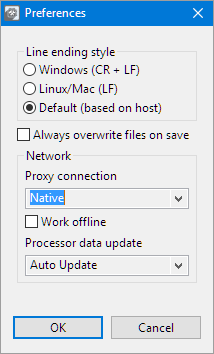

I think your proxy might cut off the connection. You might change the proxy settings under Edit > Perferences:
Native is the default, and uses the system default proxy settings. Not sure if this is causing the issue on your side.
Erich

Hi Erich,
I tried both options and no help. Our IT guy says that it is likely related on server side.
Can I change something in *.ini file to make it work?
