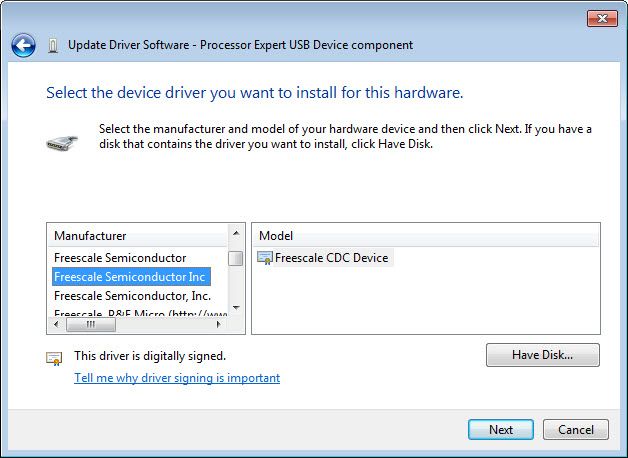

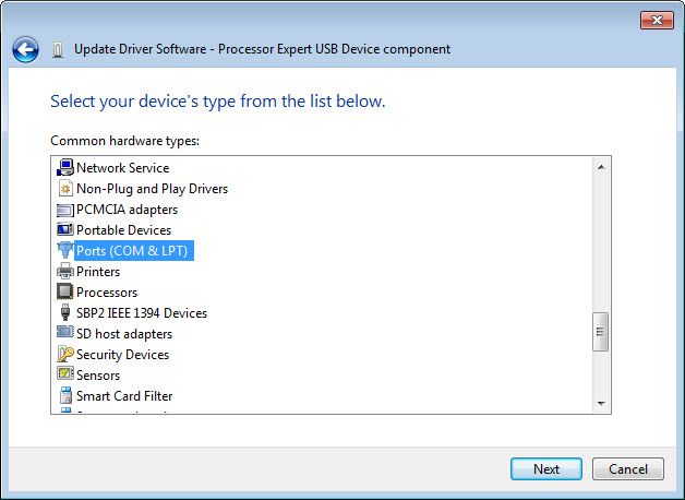

Hello Philipp,
You have to create this CDC component "manually" and do some modifications in generated code in order to get it working. Here, you can find some steps that I followed to create this CDC + MSD project in FRDM-K64F.
  • Add fsl_usb_device_msd_class to your project (4 components will be also added, among them, you can identify the fsl_usb_descriptors component that will be modified later).
  • Configure fsl_usb_device_msd_class component as desired (enable USB RAM DISK if necessary).
  • Configure fsl_usb_descriptors as follows:
    • Class Code:
    • Class list will be 1 by default, so you need to add another class (set to 2). Class 0 will handle MSD configuration and Class 1 will allocate CDC configuration.
    • Modify Class 1 as shown below:
    • Set 2 interfaces to this class (One is used for control and other for data), configure them as follows:

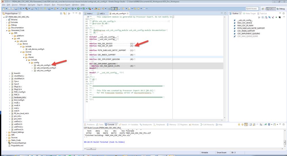

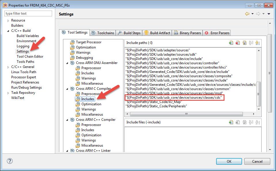

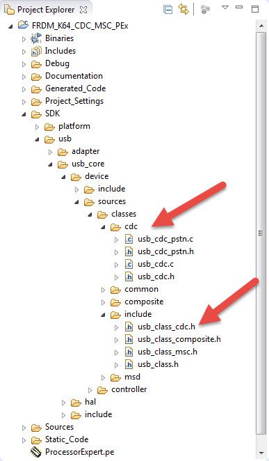

  • Generate code. Now we proceed to do some modifications on generated code (For next modifications, you can use CDC_MSD example available in KSDK 1.3), I am adding a preprocessor definition to identify the added code.
  • In usbDsc1 file, include reference for a header file that will be created later (named cdc1.h):
#include "cdc1.h"
  • Modify lenght size for usbDsc1_Full_Speed_Configuration_1:
#if ADD_CDC_SUPPORT
        0x47 + 8 + 5 + 5 + 4 + 5,0x00,       /* Total length of data for this configuration */
#else
        0x47,0x00,                           /* Total length of data for this configuration: 71 bytes */
#endif

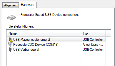

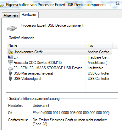

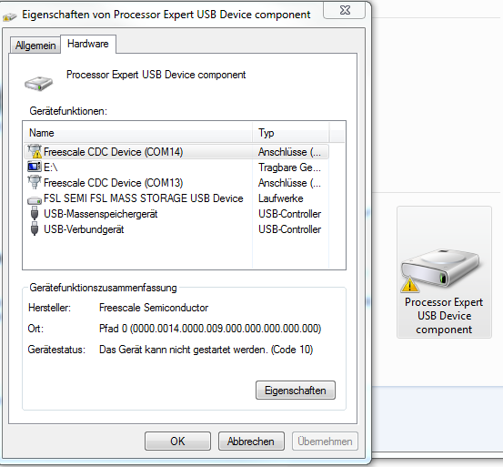

philipp
Hi Isaac,
thanks again - sorry I had vacation.

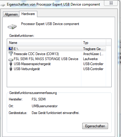

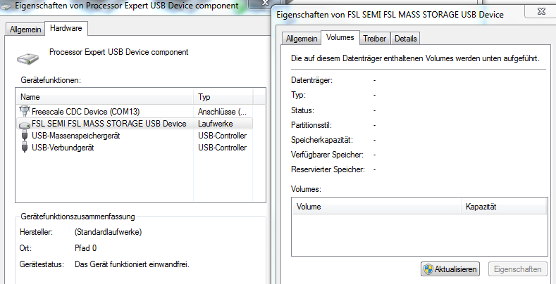

I still have problems with the CDC_MSD.
If I debug the code and plugin the TWR K60D and the TWR SER with USB, then everything is working. Via the TWR-SER the device is recognized as MSD and CDC - the loopback is working. If I send text, it is send back. The K60 is recognized as Debug Port (as usual).
BUT: If I plug the TWR-SER out and then back in, MSD is working but CDC is not. MSD and CDC is recognized but there is also an "unknown" device detected. If I send data to the CDC (same port as before) nothing is returned..
The program just works fine in debug mode... Do you have an idea about that problem?
Thank you!

Hello Philipp,
Does it happen every time you disconnect and connect the device again, doesn't it? Have you tried to reset the board every time the board is disconnected?
It seems to me that something in CDC application isn't being closed/finished correctly and when USB  is connected again it cannot initialized correctly, would you be so kind to share your project with me?
Isaac

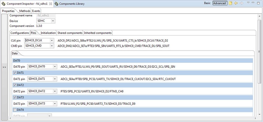

Hello Philip,

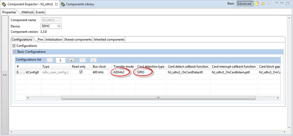

You can add SDHC and SD Card driver support for your current project with Processor Expert, however, you MUST modify the current MSD application example that uses RAM disk instead of SD Card. For this purpose, you can use the MSD Device example code that is located on <KSDK_1_3_PATH>\examples\<BOARD>\demo_apps\usb\device\msd as reference.
Following you can find the steps needed to add this PEx support, but application must be changed manually by your own:
Before anything else, be sure that you disable code generation for USB components.
  • Add fsl_sdcard component to your current project. On configuration tabs be sure t oselect fsl_sdhc component as your inherited driver (selected by default)
  • In the Inherited components tab, select the > button to configure SDHC according to your needs:
  • Configure Transfer Mode type, card detection mode and pins that will be used by SDHC controller, next configuration was taken from FRDM-K64F's example (Also, you must check pins that are used for SDHC interface in your board):
  • In case you want to use interrupt for SDHC module, you can enable them in Initialization tab.
  • If you select the GPIO detection mode, you will need to add this GPIO component by your own: Add a fsl_gpio component.
  • Configure SD Card detection pin (Input) as desired, In MSD Device example it is configured to generate interrupt on both edges and adds a pull-down resistor on the pin.

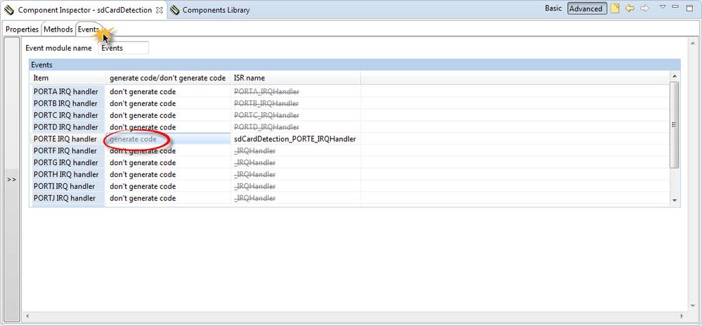

  • If you want to use interrupt to detect attachments/detachments for SD Card, go to Events tab and generate the IRQ handler for proper pin PORT:
  • Now, you can save changes and generate code. At this point you will have added SD Card and SDHC drivers to your current project.

Now it is recognized and says it is working properly. But I can't see the SD card..
I am still not sure where the problem is.. the Pins should be correct..
Would be nice if you can help me one last time!
Thanks!

philipp
Hi Isaac,
thanks for your help!
The read/write callback is not called during debugging.. initialisation and detection is working.
Here is the callback:

These are all modifications that need to be done on Generated code (be sure that CDC configuration allows to support more than 3 endpoints):

CDC class support files are missing, you need to include them so, create a new folder (cdc) under SDK > usb > usb_core > device > sources > classes and add cdc files that are located at: C:\Freescale\KSDK_1.3.0\usb\usb_core\device\sources\classes\cdc, also in include folder, add usb_class_cdc.h file that is located at: C:\Freescale\KSDK_1.3.0\usb\usb_core\device\sources\classes\include.
In project properties, add next path:
"${ProjDirPath}/SDK/usb/usb_core/device/sources/classes/cdc"
Now, just add cdc application files (where callbacks and initialization is made).I am attaching my working project, so you can give a look to cdc1.c and cdc1.h files for reference.

philipp
Hi Isaac,
thanks for your answer! It really helped me.
But now I have the problem from your note - only MSD is recognized. I tried to update the cdc driver but it didn't work out.
That's how it looks. The device is recognized as "USB Device Component" and also as a MSD. I updated the driver for the COM13 Port but when I listen on the Port with Termite nothing happens. If I try to update the COM14 Port, it's not possible because the device can't start.
Do you know how I can fix it? I guess the problem is the driver - where can I get the correct one? I attached the driver I used.
Thank you very much!
Philipp

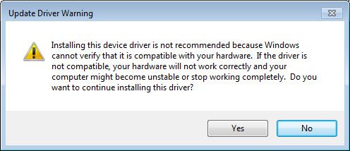

Hello Philipp,
You must go to Device Manager in your PC and will find that Device is not installed correclty (If this is not shown as it, then right click on device and select uninstall, unplug the device and then plug it again):
  • Right click under Processor Expert USB Device Component and select Update driver software, select theLet me pick from a list of device drivers on my computer, Click Next:
  • Then, select the Ports (COM & LPT) device type and click on Next button:
  • Select the CDC driver from Freescale semiconductors and click Next as shown below:
  • A warning window will appear, select Yes and wait until installation is finished:
  • Finally, CDC Device must be shown on COM Ports:
I hope this can help you!
Isaac

philipp
Hello Isaac,
thank you very much. The problem was, that PE was overwriting the changes in the code. I set the code generation to "don't write generated component modules" and now it's working. I can update the driver and the MSD and CDC is recognized.
