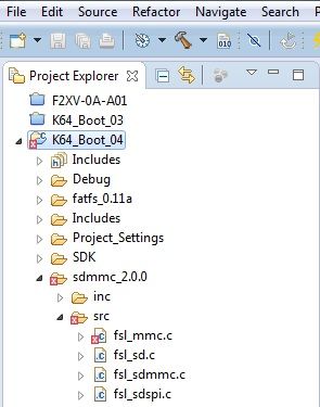

neilporven
Senior Contributor I
Hi Isaacavila,
I imported the sdmmc2.0.0 folder and added the PATH for it and I am now showing an error inside the sdmmc2.0.0??
Here is a picture:
Here is the path:
"${ProjDirPath}/sdmmc_2.0.0"
Here is the console error:
DescriptionResourcePathLocationType
fatal error: fsl_card.h: No such file or directoryfsl_mmc.c/K64_Boot_04/sdmmc_2.0.0/srcline 32C/C++ Problem
make: *** [sdmmc_2.0.0/src/fsl_mmc.o] Error 1K64_Boot_04C/C++ Problem
It looks like if its having an issue with fsl_card.h, not sure if maybe I need to include another folder?
Have you seen this issue before or from looking at this know what is happening?
thank you,
Neil Porven

isaacavila
Hello Neil,
If you look at {KSDK_2_0_PATH}\middleware\fatfs_0.11a\src you will find a 00readme.txt file in which, there is a note at the end:
"Low level disk I/O module is not included in this archive because the FatFs module is only a generic file system layer and not depend on any specific storage device. You have to provide a low level disk I/O module that written to control the target storage device."
This way, fatfs middleware has folders for different storage devices like mmc, ram disk, sd disk, etc. You only need to add the storage device you want to use and also, you will need to add their drivers. For example, if you will be using ram_disk, your structure should be like this:
And, you will need to include next paths:
Also, notice that you will need to change the ffconf_template.h file for ffconf.h, due ffconf_template.h is only a template for current fatfs configuration. Inside this ffconf.h file, there is a definition for different storage devices:

Does ti make sense to you?
Isaac
