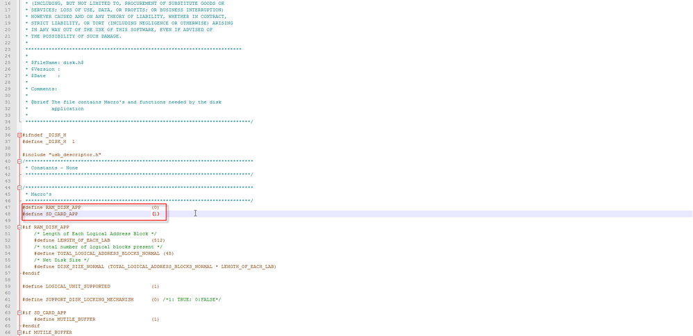

Hi Neil,
As I know, ksdk 2.0 has updated fatfs to 0.11a, you may try it when it is available. and ksdk 1.3 has provided a demo which is based on USB MSD device application , and it supports SD disk as well, you may modify the disk.h as below to add SD support.
For more details ,please refer to "C:\Freescale\KSDK_1.3.0\examples\frdmk64f\demo_apps\usb\device\msd"
Kan
