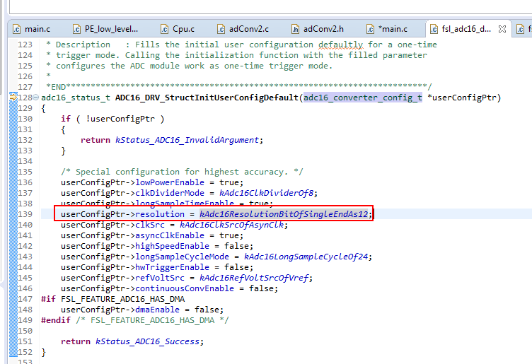

Hello ,
About  this chip , when use the differential mode , it can output 16 bit data.
- And about your requirement, on one hand, if your project is only KSDK (without PE) , i recommend
you refer to the demo code under KSDK (for example the demo on TWRK60100m board) to know how
to use the API, configure the 16 bit here :
then build the KSDK lib , then  use this function :
    ADC16_DRV_StructInitUserConfigDefault(&adcUserConfig);

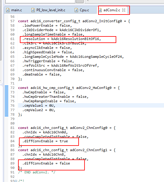

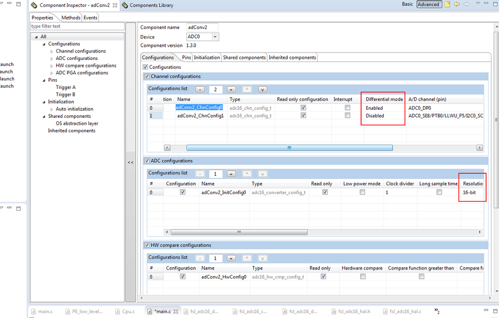

- On the other hand (i recommend you use this method) . create one SDK+PE project,
then you only need configure the "fsl_adc16" component , then the code can generated ,
  for example configure it as this :
the related code :

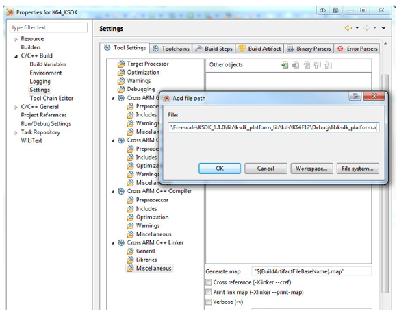

Hello Snehal,
- About the create one KSDK project on KSDK ,you can refer to here : Writing my first KSDK Application in KDS - Hello World and GPIO Interrupt
After read this , you will know how to include the lib
