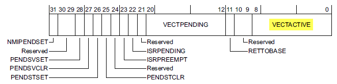

- If the application ends up in an unhandled interrupt, you should be able to inspect the ICSR register at address 0xE000ED04 to see which interrupt vector is active:

I looked into the register at 0xE000ED04, which read 0x03F04004, indicating a MemManage exception. The MemManage fault status register is 0x00, and the MemManage fault address register is 0xF8ED00E0. This only occurs when I do not set the SRAM.
If you have any other suggestions for what I can look into, please let me know.
