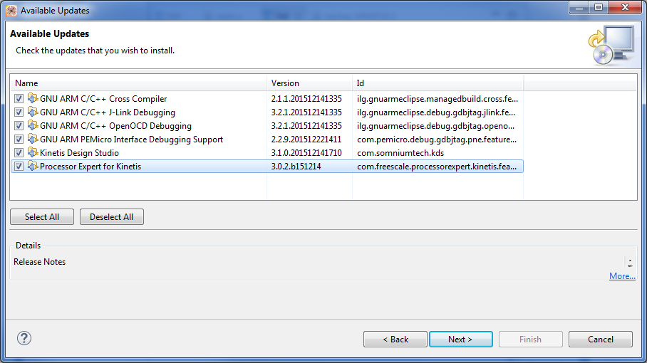

I tried extracting the zip to a folder called C:\freescale\KSDK_2.0
Next I tried to create a PE project, but PE was not able to find the folder.
Can anyone explain the correct way as the "getting started guide...." just says,
  1. 5.2.1 Windows® and Mac® OS instructions
  2. 1. After installing KDS, check for available updates…..

Hi therealfreegeek,
The steps required for Mac OS are identical to those for the Windows operating system.
The only difference is that the IDE looks slightly different.
So it means this table of updates
agree with conditions and update it
Please, are you successful at this or do you have any problem with MAC platform?
Iva

Hi, I have KSDK 1.3 successfully working with KDS under windows, my question is regarding how to make Processor Expert work with KSDK 2.0.

Short answer is Processor Expert is not supported for KSDK_v2.
Longer answer:
A new set of online tools called Kinetis Expert replace much of the PE functionality.
Please review: Kinetis Design Studio V3.x with Kinetis SDK V2.0
