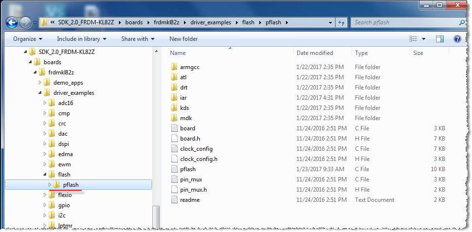

You can try to use the attached pflash.c and startup_MKL82Z7.s test on your FRDM-KL82Z board.
Using pflash exmaple in SDK_2.0_FRDM-KL82Z.

I loaded the example and modified it.  The two source files attached in ZIP file for reference.
Folder locations:
C:\SDK_2.0_FRDM-KL82Z\boards\frdmkl82z\driver_examples\flash\pflash.c
C:\SDK_2.0_FRDM-KL82Z\devices\MKL82Z7\iar\startup_MKL82Z7.s
