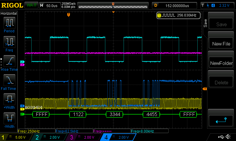

I have a KL27 with a SGTL5000 audio codec using the I2S SAI peripheral using Kinetis SDK 2.1.  I'm able to setup and send data as expected, but the DMA transfer seems to fire the callback exactly one I2S frame too early.
I suspect that the DMA callback fires when all the data is written to the FIFO, but the FIFO hasn't been written out the serial line yet.  The DMA callback in the fsl_sai_dma driver then disables the I2S transmitter and it appears that the last frame is stuck in the FIFO.  If I repeat the transfer, the last frame appears immediately on the wire and the problem repeats.
I've captured this with my scope to confirm my suspicions:

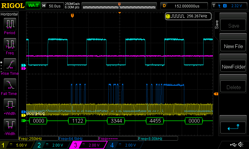

If I modify `SAI_TransferAbortSendDMA()` and comment out the the `SAI_TxEnable(base, false);` line so that the I2S transmitter stays enabled then the last byte shows up on the scope, but something is broke and subsequent transfers fail and I haven't debugged this yet, but I suspect a SAI FIFO error:
Does anyone have a solution to this?  It seems that disabling the SAI transmitter needs to be delayed until after the last frame is on it's way out as opposed to sitting in the FIFO.

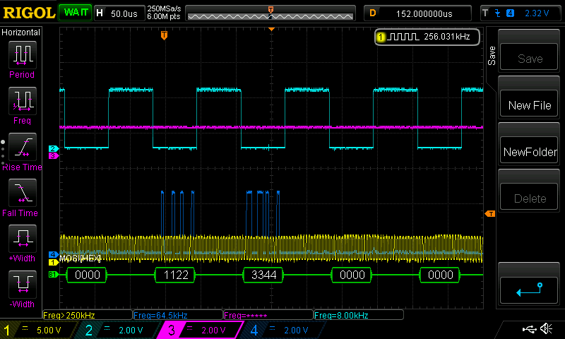

I worked around this by turning on the FIFO empty warning IRQ in the DMA About Send function instead of disabling the the transmitter.  In the FIFO empty warning call back I then disable the transmitter and it works as expected.
I threw together a patch to share.  Hopefully NXP can implement an improved version in to the next SDK release or suggest a better solution.
Working scope trace:
Link to Github gist of the patch.
