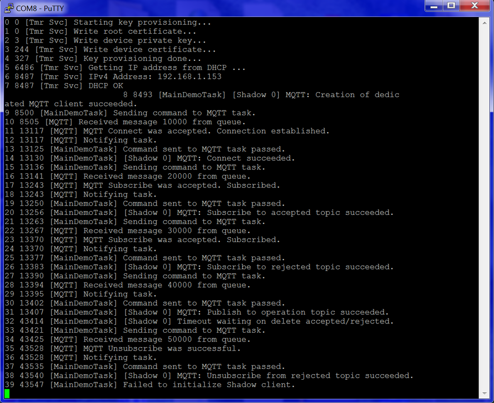

A while back I built a SDK with Amazon FreeRTOS for the FRDM-K64F. Which, as far as I know worked fine. Next I downloaded the aws_shadow_enet example project. I made my AWS account and configured the FRDM-K64F as stated in the readme file included with the project. After running it, I noticed that the K64 has some issue with the operation topic. The output in the terminal window looks like this;issue1.PNG
Reading through the readme.txt included in the project directory this seems to be one of many subscriptions to topics. I was wondering if anyone else encountered this issue.
Thanks for any help you can give.

Hi Kenneth Moore,
   So sorry for my later reply, because my IOT internet is blocked, now I just have finished it.
   Today, I have test the K64 aws_shadow_enet project, it works OK on my side, this is the log, a little long:

So, it works OK, the project have no problem, this is confirmed.
From your description, normally, this problem is caused by your aws thing create side, the policy, the certificate.
Actually, the SDK aws_shadow_enet readme.txt is really very simple, it will make the customer lost some step.
But don't worry, please refer to the LPC54018 aws get started page, that page is in details,  please open this link:
OM40007|LPC54018 IoT Microcontroller Module|NXP
Refer to the get start, configure your thing and policy, and certificate again, do it step by step, maybe your first step create an activate user already have problem.
Please try again, if you still have problems, kindly let  me know.
Kerry

Thanks Kerry!
Sorry to get back to you so late on this one.
I figured out what was wrong, I was using the wrong AWS Thing name when I defined the clientcreditialIOT_THING_NAME.
I used the full ARN there on accident. After I fixed that it all worked fine!
Thanks again!
Ken
Kerry
